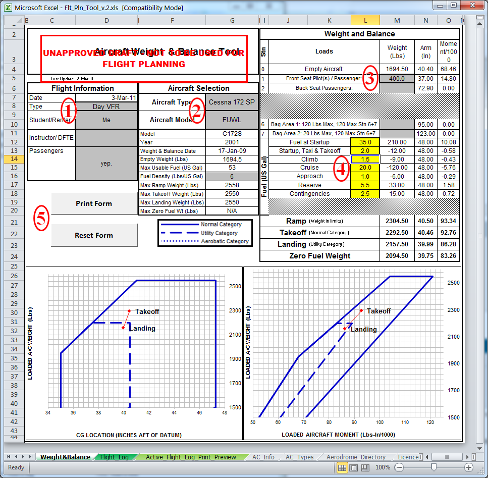

My friend, while working on an IFR rating in an airplane that ought never to have been in cloud in winter, developed a healthy respect for ice after one flight in particular. Ice and tailplane stalls.
The W&B comments above got me to thinking; I have a rather fancy Excel based W&B tool that I put a fair bit of time into developing about 2 years ago. Was intended for a flight school but never used by them. Does all sorts of neat stuff;
-maintain list of AC types, including max weights, station weight limits, CG envelopes for various categories, max fuel, standard / minimum planning fuel for various flight phases, etc
-maintain list of individual AC with specifics such as CG and weight
-to use, enter pilot, pax, pick a/c type, individual a/c, the enter weights and fuel
-flags if any conditions out of limits, provides detailed errors
-***PLOTS takeoff and planned landing CG/weight on CG/moment graphs***
-provides summary prior to printing
-if notes in summary (ie, "13.9 USG fuel must be burned after startup, taxi, takeoff & climb to be in the Utility Categoy CG envelope", and "8.6 USG fuel will be available for use in the Utility Category CG envelope. Approach, reserve & contingency fuel is not included in this figure"), these notes will be included on printout
Weight & Balance Tool screenshot 1
Weight & Balance Tool screenshot 2
Anyway, if anyone wants a copy for personal use, send me a PM, I'll be happy to share it. There will be a fee (or barter for flight time) for commercial use.

Hah, I'm inclined to agree with most of what you've said. The honest reason I put that together, is that I was going back to finish a CPL after about an 8 yr hiatus from flying, and the FTU I was at required a written W&B every time.... And the brand new instructor required me to write on paper all the WB calculations - for the same 172, with the same fuel, and same load. Whenever we went flying. I was grounded once for not having this on paper. I was not impressed - all past flying had been with Cadets, or with fairly experienced older instructors, and this sort of nonsense was unheard of. So I made a pretty tool to keep them happy and make it easier and faster to do.....unfortunately, they never approved it, and I still had to rewrite the WB on paper every time, which made me rather annoyed.
But.... I have the tool, and it's been sitting unused for years... Probably about 200 hrs of work in it, and I hate to think of it going to waste - especially when I see the godawful Excel based tools in use at most FTUs
Colin

Check the c of g.. Now reduce the fuel load and see how much it has moved...Good grief in most of these planes (not all of them) reducing weight through fuel burn will move the c of g forward
Now you should be able to load the plane within weight and balance limits by thinking it through in your head...Yeah yeah, I know. That is not the way you were taught in flight school.
But from some of the stories here, maybe , just maybe, there is a better way.
The truth is, which no one ever seems to want to speak aloud about, is that small planes are safely loaded every day without reference to charts, books, written calculations.
Know your plane, its limits, and use bloody common sense. One of the main problems is everyone is trying to comply with TC directives. learn properly, and , of course...be safe.
so no one ever admits that few are done
The W&B exercise is an excellent training exercise because it involves things like standard weight of fuel and persons as well as w&B...but in these types of airplanes common sense is the key.
If you want to hear scary W&B stories I have seen 1000 hr commercial pilots who knew nothing about things like zero fuel weight, or landing weight limitations, but they could pull out their little pathfinder and spend 30 mins doing a W&B calulation for a 40 min flight with just them and 1 1/2 hours of fuel on board...ZERO common sense.
Incidently, if you really feel it is necessary to do a W&B on every flight in your 172, buy yourself a SeeGee calcualtor. Best thing in the world for doing this. Takes a minute and allows you to shift loads around. They have a website I think.
