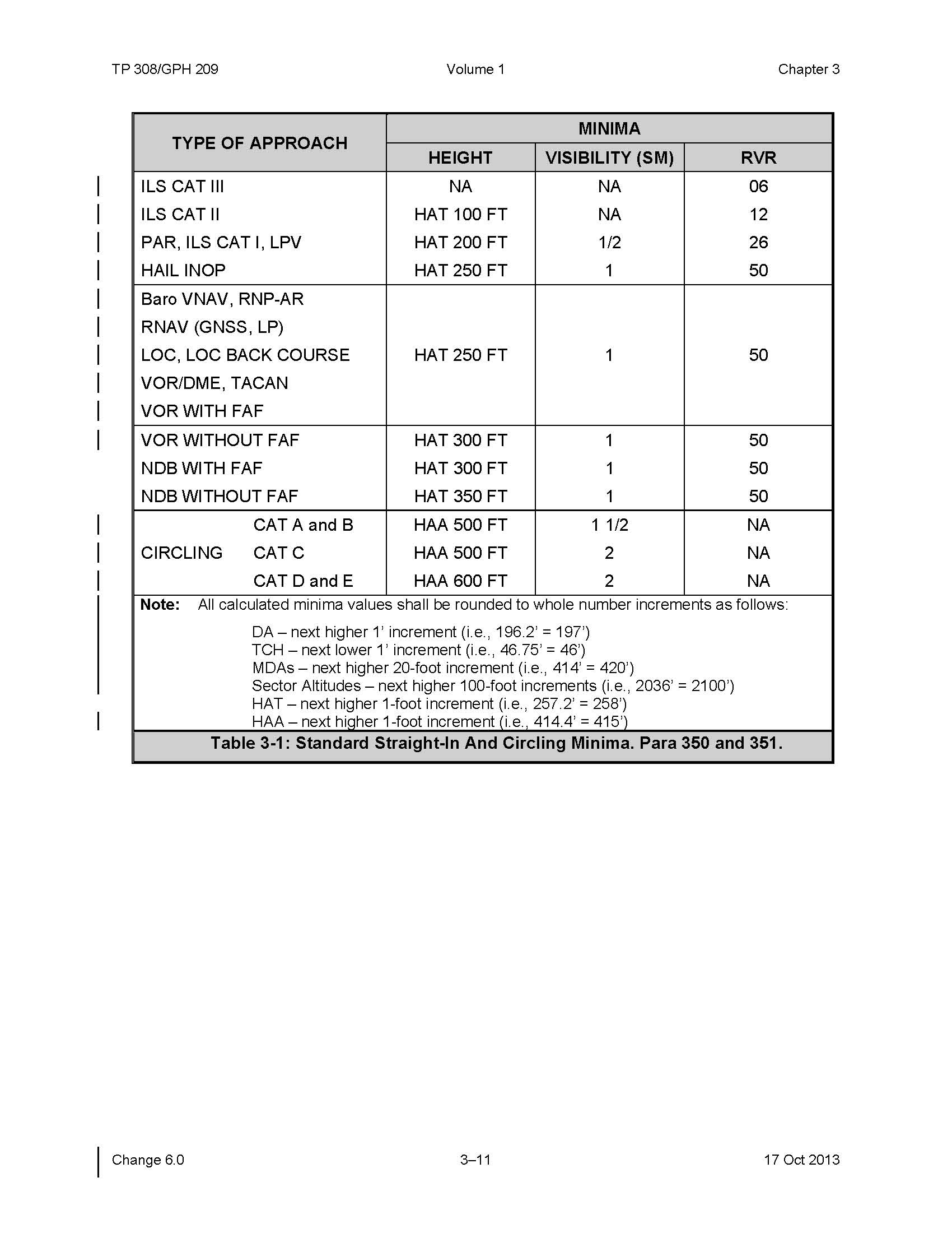

The minimum visibility published for a non-precision IAP is 1sm, you won't see any NPA's with a vis lower than 1sm by design criteria. Authorization for lower visibility requirements are company specific. I didn't know Jazz and EVAS had that authority.........
Pages from TP308E-C6.0.jpg (187.46 KiB) Viewed 8489 times
