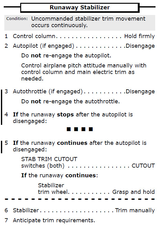

It is true, is it not, that MCAS is not active when the autopilot is on? That is one of the operating principles of the system. It is also true that MCAS is not active when the flaps are extended? The answer to both of these questions is clearly yes, that MCAS is silent in automatic flight and with the flaps extended.
I did not say that engaging the autopilot was part of the stab trim runaway recovery, that was not the question. The stab trim runaway checklist is provided as follows:
Stab Trim Runaway.jpg (167.7 KiB) Viewed 4500 times
And it is equally true that the use of the manual trimming switches on the control column nullify MCAS - or more specifically the nose down trimming action - while they are used. Perhaps my choice of words should have been better but the intent is that manually trimming overrides the MCAS caused nose down trimming action.
MCAS, to the pilot, is indeed an uncommanded stabilizer trim movement. Have another look at the Runaway Stabilizer NNC I provided: "Condition: Uncommanded stabilizer trim movement occurs continuously". With MCAS in action:
- is there trim movement. Yes.
- Is it uncommanded (i.e. not selected by the pilot). Yes.
- Does it occur continuously. Yes (10 seconds at at time)
MCAS satisfies all three conditions of Runaway Stabilizer.
I agree with the raison d'etre of MCAS, which is providing positive pitch stability at high angles of attack which is not naturally present owing to the placement of the engines. And I agree that one should never get to that area of the envelope but there are idiots who might and that's why the FAR's are written to provide positive stability to get the nose down and MCAS is the vehicle to do that.
Is the Speed Trim System (STS) a runaway trim - no, as it fails to meet the definitions as it does not occur continuously but rather intermittently. Moreover, it is a normal operation of the trim; MCAS is not, particularly when it fails as we have seen in these accidents where the angle of attack is nowhere near high.
MCAS not being removed is not surprising as the certification requirement that necessitated it in the first place (positive stability throughout the entire flight regime including high alpha) has not changed.
According to ALPA in that article and Southwest (and others), they consider an MCAS event a Stab Trim Runaway event which demanded the use of the procedure provided here. This was also stated by the FAA administrator, who is an experienced airline pilot. I think everyone else in the industry understands what a stab trim runaway looks like, regardless of its cause such as MCAS, a stuck trim switch, a short circuit in the wiring, etc. The cause is irrelevant while in flight.
BTW, I have 16 years on the B737 so I have a pretty good understanding of its operation plus another 5 on the 767/777/787 which all have similar stab trim runaway procedures except the back-up trim is electric not the hand crank.

The QRH page you posted isn't current and hasn't been since the fall.
If you believe MCAS is uncommanded trim and thus should be cut out anytime it runs how will it remain certified?
I think I'm done here. Enjoy the bigger Boeing's.

Answer: there is no difference.
That is false.
1) The Standard Runaway trim fault does not have a stall warning and stick shaker associated with it.
2) The Standard Runaway trim fault is not associated with an IAS Disagree alert, which when it happens at take off, calls for the pilot to disconnect autopilot and auto thrust and maintain 10 degree nose up and 80% N1 (The MCAS fault kicks in at flaps up after the Stall warning and the IAS Disagree)
3) The Standard Runaway trim fault does not stop when you input some electric trim, pause a number of seconds, and -re-activate again, and so forth in a loop.
I read somewhere that the Ethiopian PIC had selected 235 in the speed window at some point, and then never touched the throttles after that, thinking the speed and power issue had been taken care of, when in fact the aircraft was at high power setting until impact. Had he previously disconnected the auto thrust as part of the Unreliable airspeed drill but forgot about it ?
I beg to differ. The UAS (stick shaker and IAS disagree) was present from the moment the aircraft lifted off, about two minutes before the flaps were raised and MCAS kicked. They had two minutes to do this drill in isolation and didn’t. It is important to note that the Lion Air incident crew did do the drill and both accident flights did not. How do you explain the UAS NNC NOT being performed in the first two minutes of these flights?
If UAS and MCAS occurred simultaneously you would have a valid point, they did not.
The SW B737 crew that dealt with the engine explosion and rapid depressurization had simultaneous failures, the MCAS aircraft did not.
What is a standard runaway trim emergency? A runaway trim is anytime uncommanded trim is being applied, continuous, intermittent, or whatever. This is common to to virtually all aircraft. The duration, source, cause and minutia of its characteristics is irrelevant in flight. But to your point, how about a trim failure caused by loose wire shorting out intermittently? Would you treat that as a runaway and shut the system off, per the Stab Trim Runaway or would you continue as it doesn’t meet the “standard” trim runaway. I know what I would do.
