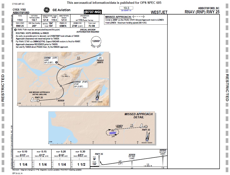

It is a standard T shaped LNAV design on to Runway 07. The only approach to 25 is the restricted RNP approach that WestJet uses.
The part that really sucks is the NDB 07 is not annotated (GNSS) so you can't use the overlay as a non precision approach for IFR fight training or the flight test.
The cynic in me is thinking that because the airlines can use the RNP approach to either end of Abbotsfords main runway even when the ILS 07 is down, Navcanada's "give a shit" is not real high as they are only inconveniencing flight training and non 604 GA.

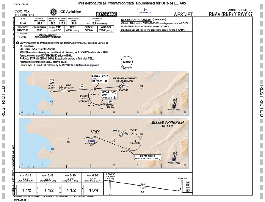

But the teal team can use:
YXX RNAV Y 07.jpg (153.94 KiB) Viewed 3461 times
and
YXX RNAV 25.jpg (175.17 KiB) Viewed 3461 times

Rumour has it that the plan is to revoke the procedure altogether.

The current RNAV approach listed in the CAP and NOTAM'd off does not meet the ICAO standards and cannot be fixed. It will be withdrawn from the CAP and a new approach will be created. It is planned for March of 2015 at this time.
