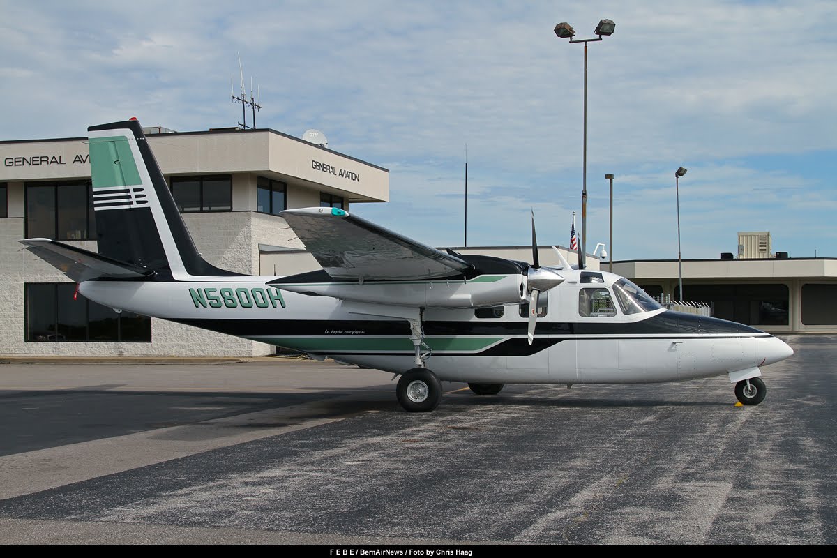

Re: Private American A/C Down in CYRT.
Very clean looking aircraft, prior to the forced landing anyway!!!
- photo Chris Haag @ KPKB Mid Ohio Valley Regional Airport WV, JUN10/10
- N5800H.jpg (142.02 KiB) Viewed 3414 times
