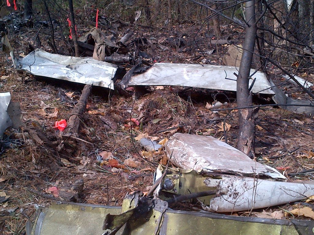

Wreckage via TSB photos, note anti-icing panel photo - obviously very important as
this is what brought down the last TBM whose decent was errily similar.
http://i845.photobucket.com/albums/ab20 ... ngleft.jpg
http://i845.photobucket.com/albums/ab20 ... -FBKK2.jpg
http://i845.photobucket.com/albums/ab20 ... -FBKK3.jpg
http://i845.photobucket.com/albums/ab20 ... -FBKK4.jpg
http://i845.photobucket.com/albums/ab20 ... -FBKK5.jpg de-ice panel
http://i845.photobucket.com/albums/ab20 ... -FBKK6.jpg

From 12:04 at 7,000 to 12:16 at 25,000 is 12 minutes and with that rapidly increasing altitude cam rapidly decreasing useful consciousness.
The sudden obvious loss of control could well be a combination of problems and then what is really disturbing is all the witness reports of loops, inverted flight etc.
It appears that the final cause of this accident was disorientation caused by the hypoxia and his medical problems that led to the decisions that caused the hypoxia.

The question that jumps out of the report is that Flight Manual requires the pilot to sit in the left seat. The CARS require oxygen, he chose to not to sit in the left seat, and chose not to turn on the oxygen, he chose to ignore all the warnings.
That right there, convinces me that there were at least psychological and ore personality factors that led to improper operation of the pressurization, the lack of auto-pilot that all contributed to hypoxia.
The ultimate cause of the accident, based on witnesses is a loss of control which was precipitated by the above factors. It did loops, inverted flight etc, which all involve High G that he most probably would not have been able to handle.
The report could not apparently "link" the factors together but the issue I have is, every accident is a learning opportunity and while we may never know the exact cause, unless all the possible scenarios are explored.
I've posted the scenario's that leap out of the document and which I've posted.
My conclusion is that like most accidents, personality and or mental health issues drive most accidents.
It's frequently a combination of errors and this accident starts with a medical, medical problems, a walk around, a decision to go with out Oxygen contrary to the CARS which is proof positive that he had a personality issue that affected his ability to make decisions.
That's confirmed by his decision to sit in the Right Seat which may have fatally prejudiced his ability to fly the airplane.
On the balance of probabilities Hypoxia was a cause which with the above factors made him an accident going to happen
