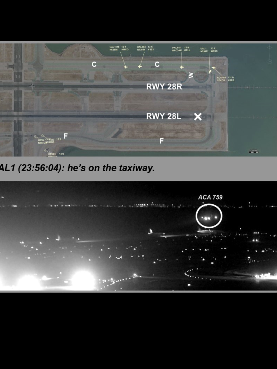

The NTSB has released an updated report on the taxiway go around.
It is to say the least interesting.
Especially the picture showing AC just about to fly over the first airplane holding at the end of the taxiway.
The CVR had been over written and the crew claimed they did not see any airplanes on the taxiway.
Looking at the picture maybe they couldn't see because next two airplanes had their landing lights on and that blinded them?

Cat Driver wrote:The NTSB has released an updated report on the taxiway go around.
https://www.ntsb.gov/investigations/Pag ... IA148.aspx
The captain had over 20,000 total flight hours, of which about 4,797 hours were as captain in Airbus A320‑series airplanes. The first officer had about 10,000 total flight hours, of which over 2,300 hours were in Airbus A320-series airplanes.
About 2.5 seconds after advancing the thrust levers, the minimum altitude recorded on the FDR was 59 ft agl.
It would be interesting to know just how close they really came to hitting one of those airplanes.

At 2356:10 PDT, the local controller directed ACA759 to go around. The airplane had already begun to climb at this point (see figure 4).
That puts one discussion point to rest. They did figure out something was wrong themselves before ATC told them to go-around. That makes this quite a bit less of a big deal IMO.

Well as to the lights according to the NTSB runway 28L was notamed closed and there was a lit up X at the threshold.
R28R was lit at a normal setting with approach lights and PAPI working.
Taxiway C was lit with green centre line and blue edge lighting.
The weather was VFR so why did they not figure out they were landing on the taxiway until they were almost on it ???
I sure am puzzled by this whole episode because it should not matter if you are flying a Cessna 150 or the space shuttle the picture is the same.

Wow...good image in the lower frame of how low they were.

@ digits_
"But they didn't , didn't they? They initiated a go-around because they saw the obstacle. Close, yes. Too close for comfort, yes. A near crash? Not really. Crew knew someting was wrong and went around."
I'm sorry but I have a hard time with you (and a few others) that are pretending that this is a non incident... IMHO AC 759 was going to land on taxiway C but if it were not for UAL 1's call to the tower advising them that AC 759 was lined up on taxiway C (first wake up call to AC's pilots) and then most importantly and probably the one thing that saved the whole day was the fact that PAL 115 an Airbus 340 and the second aircraft on taxiway C then turned on their landing lights as a warning to the approaching AC 759.
Some facts and comments...
- According to their testimony, both AC pilots claim they never saw the aircrafts on taxiway C, very hard to believe IMHO.
- Both pilots apparently mistook taxiway C for 28R and 28R for 28L despite NOTAMS saying that 28L was closed and had an X light up on it. 28r was fully operational with all its lights working including the approach lights. Taxiway C had its blue edge lights and its green centerline lights working.
- the CVR was overridden, so no data from that piece of equipment which I believe goes against the CARS.
- AC 759 was far enough of course (north of centerline) that the airport's radar could not see it for 12 seconds.
- UAL 1 was probably not in danger of getting hit by AC 759 because it had already turned the corner. However if you look carefully at the picture available you can see that the half end section of the fuselage of UAL 1 is light up by the landing lights of AC 759.
- Abeam the threshold and over the end of taxiway C, AC 759 is 131 feet above ground.
- AC 759 while over flying taxiway C applies go around trust at 85 feet AGL (probably after seeing PAL 115's lights) but continues descending for 2.5 seconds until it is 59 feet AGL and this near taxiway W where PAL 115, the Airbus 340 is located... The tail of an A340 is 56 feet tall, so AC 759 most likely cleared PAL 115's tail by 3 feet maybe more. Also worth noting in the pictures is that the tail section of PAL 115 is brightly light up by AC 759's landing lights.
You and others may think this is a non event and the "guys" did a great job but I beg to differ! You cannot put your aircraft into such a position and risk the lives of many onboard your aircraft and other aircrafts and get away with it. The union and AC management may want to spin this anyway they want but this was way more than "just too close for comfort".
