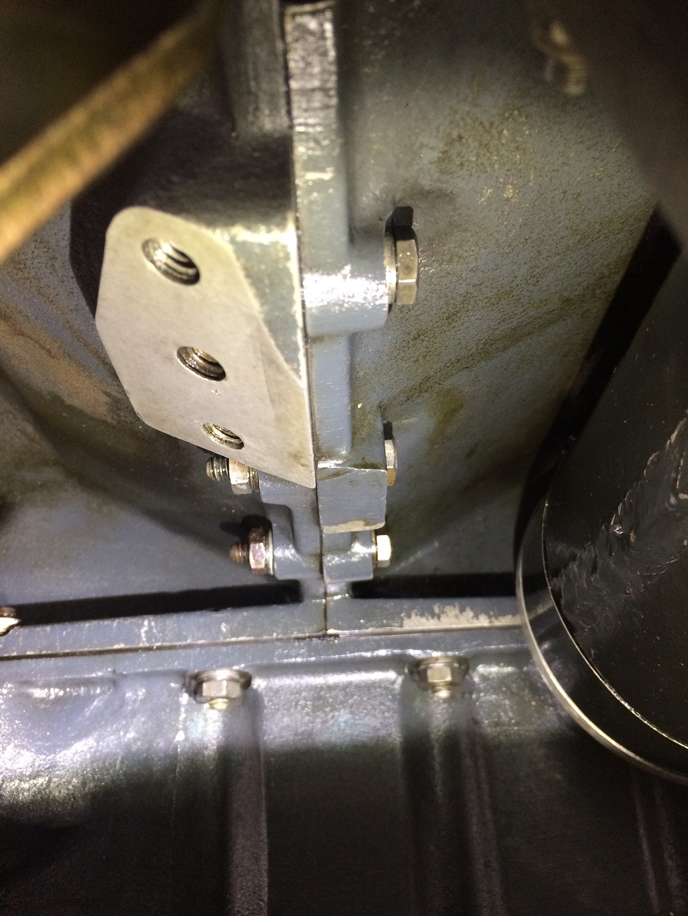

I had some help from a friend - last weekend (Sept 18th) we cleaned off the oil from as many places as we could reach using a long artist's paint brush (14") and some rags. For parts the rags couldn't reach my friend's air compressor was handy for drying the mineral spirits and oil. Later it felt dry and not greasy to the touch. We did not run the engine, deciding to see if any oil wept out anywhere without the engine running.
On Friday I went back and checked the engine. Everything remained clean except for one place where the sump bolts to the bottom of the O360 and at the front. Here's the shot as of the 17th followed by the shot after 5 days. The black shape on the right side of the images is the starter. In other words the leak faces the front of the aircraft.
I cleaned the area and went for a short flight today, circuits for 0.4 and removed the cowl for another look. It was messy again and more than what appears in the photo after the engine had been through 4 circuits. Other places still looked clean.
Looks like the leak is either from the sump's (correct term?) seam where it joins the crankcase or perhaps the split line of the crankcase. Seems more likely the sump which has a gasket visible (black line in the photo).
[Edit] - Figured out how to add images. Before and after shots:
- Oil cleaned and engine not started
- Before_s.jpg (351.89 KiB) Viewed 3553 times
- 5 days later without engine start
- After_s.jpg (367.67 KiB) Viewed 3553 times

That's very common. Most of those bolts will take a 1/4 turn every now and then. Have your mechanic go around the sump attach bolts and case 1/2 bolts and torque them down. Those things are worth checking every time you drop the cowl or change the oil.

I thought you could only torque down gasket-separated surfaces only so many times before the gaskets were compressed to the point they were no longer effective. True, I've never had this done in the 5+ years of owning the Cardinal and will talk to the mechanic about getting it done. Would be very nice to see this improved!cgzro wrote:That's very common. Most of those bolts will take a 1/4 turn every now and then. Have your mechanic go around the sump attach bolts and case 1/2 bolts and torque them down. Those things are worth checking every time you drop the cowl or change the oil.
Thanks!
Re: Seeking Advice on Diagnosing Oil Consumption
[quote="OntheNumbers"][quote="cgzro"]That's very common. Most of those bolts will take a 1/4 turn every now and then. Have your mechanic go around the sump attach bolts and case 1/2 bolts and torque them down. Those things are worth checking every time you drop the cowl or change the oil.[/quote]
Thanks![/quote]
Dependson the gasket and mating surface area but the bolts are not there primarily to stop oil leaks. If they are not torqued properly the loads are not distributed properly which is much worse.
The cork valve cover gaskets are bad in that the cover on a Lycoming has a very narrow mating surface, a few mm and it will cut the cork in 1/2 if you over tighten them.
Thanks![/quote]

Most gasket materials will "seat" after 1-2 heat-cool cycles and will need to be retorqued ( important with a new engine ) Then, I would suggest no more than once a year to check for torque on all the nuts/bolts firewall forward. I would even go as far as checking the torque on the crankcase mating bolts/nuts which don't have a "gasket" within 10 hrs of assembly. Same goes with exhaust flange nuts,,,, some systems seem to be designed to leak
,,, others will go a thousand hours and never leak. With all exhaust flanges on cylinders, NEVER let a leak progress beyond a trace amount before rectification.
