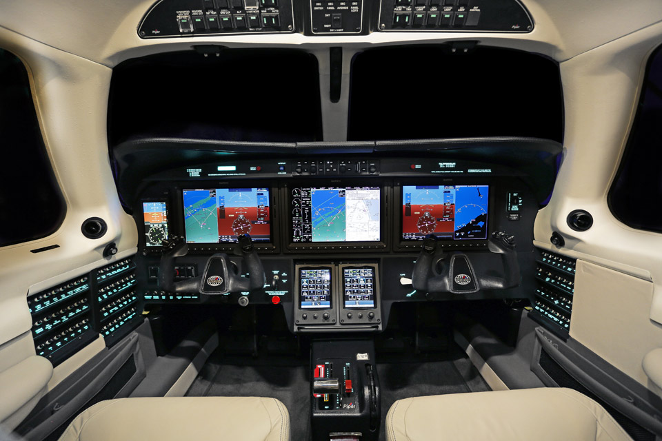

GyvAir
Posts: 1817
Re: a problem with compass swing
Post by GyvAir »
No wet compass there:
