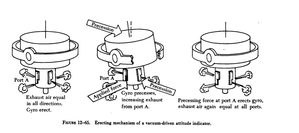

The gentleman you spoke to at the wedding doesn't understand the mechanism inside the AI.Learning2Fly wrote: ↑Mon Feb 26, 2018 2:19 pm However, while discussing this with a gentleman at a family function this weekend, he explains that the aircraft also imparts
forces on the gyro while banking, yawing, pitching, turbulence, etc. These forces can be much higher than gravity and do
not alter the performance of the gyro.
The mechanism inside the AI (the vanes that swing out of the way to enable air-jets to right the gimbal) isn't sensitive to the strength of a local force, only to its duration. The erection rate is 5 degrees per minute for the duration of the force, whether the force is very large or very small. So short duration bumps and accelerations have little effect, even if they're very strong.
Gravity maintains a constant pull, righting the gimbal at 5 degrees per minute, forever, until it's upright.
Steady turns cause relatively long duration non-vertical accelerations, but turns being what they are, the direction of the error turns too, so even in a turn of many minutes (through many multiples of 360 degrees) the accumulated error remains small. You will also note that holding patterns, in which aircraft perform steady turns through large heading changes often in instrument conditions, also include straight-and-level-portions during which the AI can reset some of the error accumulated over the preceeding sixty seconds of turning flight.
If you look up the requirements of TSO-5a (I think it is, from memory) and do some maths or some simulations, you'll see that the accumulated errors in a turn at the specified arspeed meet the requirement if the self-erection rate is no faster than 5 degrees per minute. On the other hand, an AI that erects much slower than that takes unnecessarily long to reset itself after a topple.
Moral: family weddings are bad places to learn how aircraft instruments work.
Because, as I explained, the AI self-erects to follow gravity, at a rate of 5 degrees per minute.

The self-erection mechanism for a vacuum-powered AI is part of the PPL syllabus, which I teach. I also have a non-functioning AI with which to teach it, so I'm very familiar with it. An electric AI will have a different mechanism but must follow the same general idea because it's subject to the same TSO certification limits. An AI only works if the self-erection mechanism is sensitive to the duration but not the strength of local accelerations. That's how it can both self-erect over a longish period, and still function as an attitude reference that doesn't go wonky in turbulence or turns.Learning2Fly wrote: ↑Mon Feb 26, 2018 3:02 pm Air-jets? We're talking about an electrically powered ADI, correct? I've never worked with a vacuum powered ADI, so I cannot
comment.
The aircraft is pitched nose up but the gyro axis remains vertical. Since the self-erection mechanism is attached to the gyro axis and not to the aircraft, there's no change in the force direction as felt by the self-erection mechanism and no error, regardless of how long the aircraft pitch is non-level.Why is this not an issue during climb then? The aircraft is pitched up for a long duration of time; if the level flight is corrected
to follow the curvature, how do we explain the climb angle? This is why I asked the question about high altitude cruising prior
to this post.
Whether the aircraft is in level flight, or climbing, or descneding, If the aircraft travels a sufficient distance around the globe then the fixed gyro axis isn't parallel with the new local vertical any more (pretty much the definition of "transport error") and the self erection mechanism gets to work.
By the way altitude is quite irrelevant.
That's correct. The gyro axis a) remains fixed in space in the short term and b) slowly the mechanism corrects it to be vertical to local gravity. The orientation of the aircraft and the instrument case is entirely relevant to the gyro or the self-erection mechanism (as long as it doesn't lock) so aircraft movements (roll, pitch, yaw) don't cause AI errors. You can fly in a sideslip with one wing down all day, the gyro won't tilt.I'm not sure I follow. By tilting the case you are effectively simulating the aircraft angle because the case is fixed to the aircraft
frame.
What causes a an AI to indicate incorrectly is a longish duration steady acceleration, such as on the runway at takeoff, or during a turn. The technical specifications for an approved attitude indicator are worked out so that in normal flight the aggregate error compounded over various manoeuvres remains small and in any case is always being decreased, at 5 degrees of error per minute, when the accelerations stop, i.e. whenever the aircraft is in unaccelerated flight. That makes the instrument useful as an attitude reference in IMC. Useful, but not perfect.
There's no stalemate. Long duration ascents and descents don't involve accelerations. The gyro is designed to self-erect to follow accelerations, not the orientation of the case.We're at the following stalemate now:

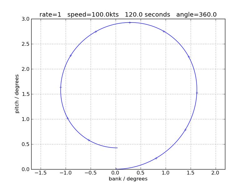

Here's the excerpt from TSO-C4c which gives the acceptable performance error in turn for a certfiied gyro attitude reference (electric, or pneumatic, doesn't matter):
Useful, not perfect.
And here's a graph of the accumulated pitch and bank error for a simulated AI in a 360 degree standard rate turn, with a self-erection rate of 5 degrees per second (if I remember right) although at 100 knots. I guess I should redo the simulation for 180mph, really.
- graph_1_100.0.png (43.88 KiB) Viewed 3199 times

Re: Experiment & Questions
The video is brief about self-erection mechanisms, but consistent with what I wrote.
From https://www.faa.gov/documentLibrary/med ... 65-15A.pdf
The AI is fixed in space over the short term, and adjusts itself to point “down” over the longer term. “Down” is the only acceleration that’s consistent in direction, so averaging the directions of the accelerations felt by the instrument over a sufficiently long period gives an adequate reference, and enable the instrument to right itself at startup and fix its own precessional errors during operation.
Reasons to erect faster are to recover from topples quicker, and to reduce the effect of errors due to precession and transport effects.
A reason to erect slower is to reduce the compounded error introduced during accelerating flight, that is, during turns, and while the aircraft is speeding up or slowing down, or pulling out of a dive. Speeding up and slowing down, and pulling out of dives doesn’t usually last very long. Turns generate bigger pitch and roll errors.
Slow turns are generally worse for errors than fast ones. In a rapid turn the direction of error reverses itself quickly. In a slow turn there’s enough time for the error to build up.
Attitude errors that occur during turns appear as both both pitch and roll errors. Imagine an airplane flying north that rolls into a right turn. The gyro senses an acceleration to the east and slowly starts to builds a bank error due to the non-vertical local acceleration. After some seconds the aircraft has turned ninety degrees and the initial east tilt error in the gyro appears as a pitch-up error, incorrectly showing a nose up attitude when the aircraft is level. Alternatively the aircraft will be flown nose down if held level according to the AI.
As the aircraft turns through east the error continues to accumulate, the direction of the error always to the inside of the turn. The biggest aggregate error occurs shortly after 180 degrees of turn.
If the aircraft continues to fly a circular path for long enough, eventually the AI error settles down to a steady combined pitch-and-bank error, showing. too much nose-up and under-representing the bank.
I have some graphs somewhere showing how the error varies with rate of turn. An AI that meets TSO-4c has sufficiently small errors still to be useful as an attitude reference during turns.
