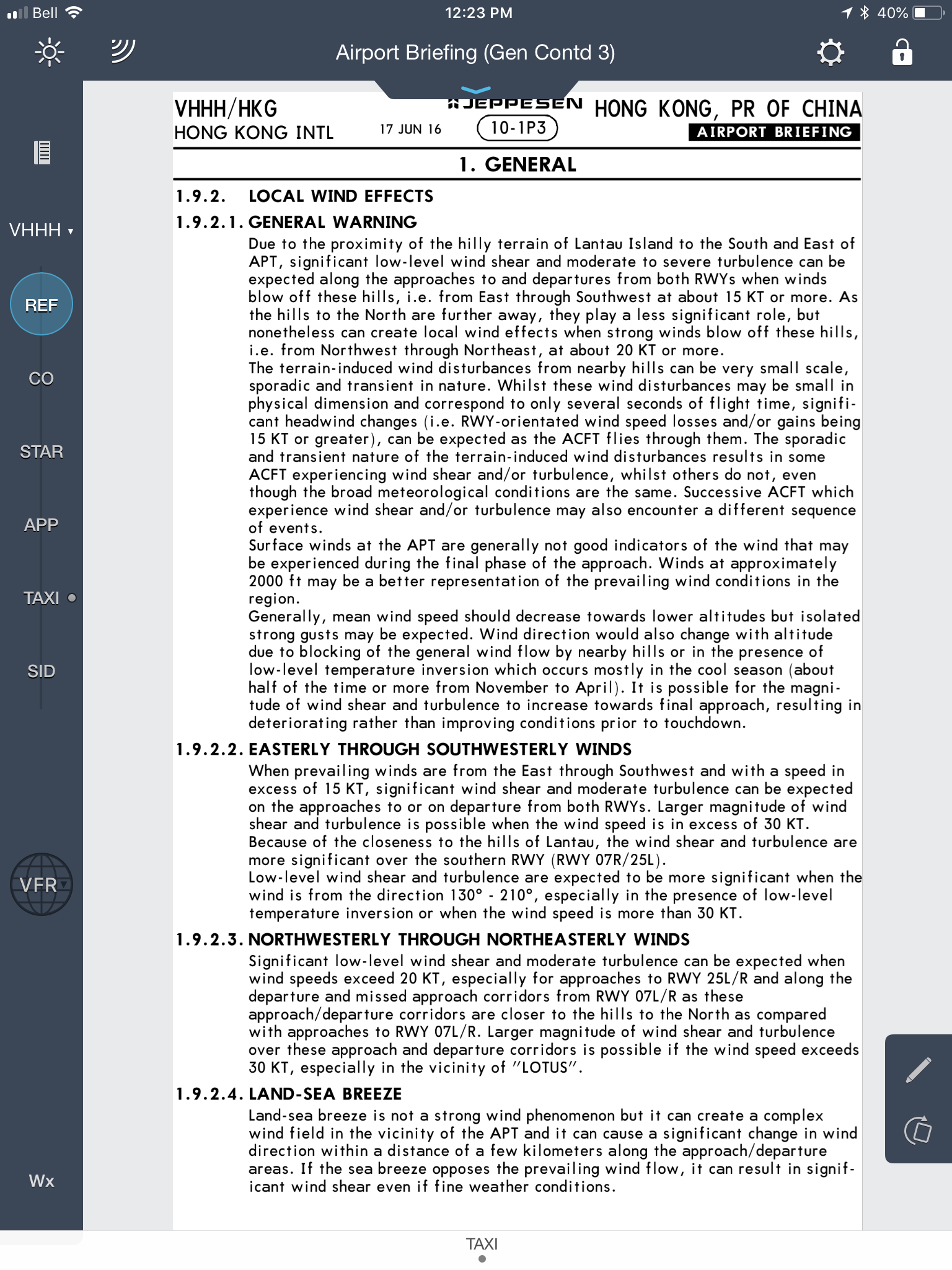

Landed on 07R with a 15 knot N wind. This scenario in HK is well known for low level windshear. Could have been a factor. Having said that, the Triple, unlike the 330, lands pretty flat and isn't known for being prone to tailstrikes. Looks like that bird airn't going anywhere for a while though.
Eric Janson
Posts: 1490
Re: Air Canada tailstrike in Hong Kong
Post by Eric Janson »
sportingrifle wrote: Thu Dec 13, 2018 4:44 pm Landed on 07R with a 15 knot N wind. This scenario in HK is well known for low level windshear. Could have been a factor.
That's not correct - airport briefing says winds over 20 knots from the N will potentially cause problems. And then for approach 25l/R and Missed approach/Departure 07L/R.

Eric...past experience has shown me that it doesn't take 20 knots to find localised bad air. 20 knots to trigger a windshear alert perhaps. The Cathay guys were speculating on this as a " link in the chain. " Anyway when the report comes out we will know. Cheers SR.

I believe you will find that for 07’s at HKG that the terrain is not particularly close on the north side, from a Hong Kong perspective that is. But....one never knows when it comes to mountainous terrain.

Posts: 5983
Eric Janson wrote: Mon Dec 17, 2018 1:45 am
I have it on good authority that it was a wind shear event.
Here's the briefing for anyone unfamiliar with HKG.
Posts: 8197
altiplano wrote: Tue Dec 18, 2018 10:53 am
Bottom line....be ready to advance the thrust. Autothrottle all the way to touchdown type guys could be less ready to quickly add thrust. Pulling the control column aft as an only response to a decreasing performance shear will bring the tail closer to the ground. Reduced flaps on approach may be helpful on a long runway like the ones at HKG.
