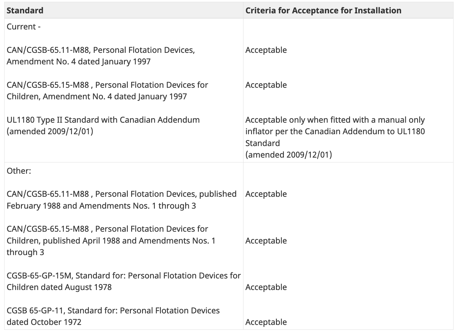

I did some further digging and talked to TC.Heliian wrote: ↑Mon Jun 03, 2019 2:01 pm
It references ch 551 of the airworthiness manual for the standard for pfd's, as long as it meets those standards.
It must be maintained as per the same instructions, life vests still have to be sent away for recertification to the manufacturer or approved facility. Inspections will also need to be done iaw your msa/manufacturer ICA.
No. You'll have to use approved ones and maintain them. You can't just have a bunch of cabelas specials.
I recommend the pouch or fanny pack style.
I'm still not convinced current life jackets need to be sent away for recert because of
That exception is being removed but until it is I don't think any recert dates would be binding because PFD's fall under the exception to meeting the standards in the airworthiness manual.602.59 (1) Subject to subsection (2), no person shall operate an aircraft unless the operational and emergency equipment carried on board the aircraft
(a) meets the applicable standards specified in the Airworthiness Manual; and
(b) is functional.
(2) Paragraph (1)(a) does not apply in respect of the following operational and emergency equipment:
(a) survival equipment;
(b) a personal flotation device;
When that exception is repealed PFD's must fall under the airworthiness manual, but the airworthiness requirments for PFD's are broader. See the screen shot showing PFD requirements from chapter 551. Where "Life Preservers" and "Individual Floatation Devices" must have CAN-TSO numbers, Personal Floatation devices need only to meet the CAN/CGSB-65.15-M88 or UL1180 Type II standard.
- Screenshot 2019-06-03 15.26.24.png (226.24 KiB) Viewed 4142 times

What models have people here ordered for commercial use as of Sept 6th?
partsguy.ca
- Rank 0
- Posts: 3
- Joined: Wed Sep 15, 2021 1:58 pm
Re: Mandatory life jacket wearing coming for most seaplanes
I have been reading this thread with great interest. I too would like to know if any Canadian Commercial Operator(s) have purchased a Pouch Type Device that meets the standards and has been given the nod by TCCA as being compliant. Many people are aware of the CAR change, but the consistent question seems to be...."OK - What do we use?" In the real world of Life Saving - I completely agree with "Something" is better than "Nothing", (my teenage kids hated it when I made them put on a Mustang Inflatable in our Family Boat) but that will not get you past an audit.ragbagflyer wrote: ↑Fri Aug 14, 2020 1:24 pm What models have people here ordered for commercial use as of Sept 6th?
What is used in a Recreational Float Plane is not really my question...I'm interested in hearing from Commercial Ops Folks.
Maybe its too soon..
Thanks.
Dss aviation in Nova Scotia. Ask for Blake as he is up on what TC requires.
