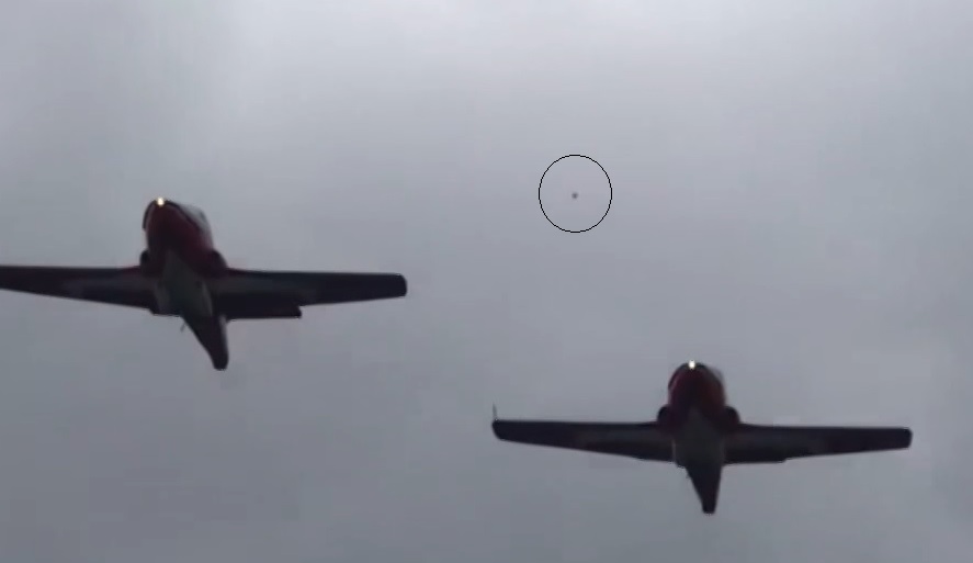

cncpc
Posts: 1737
Re: Snowbird crash in CYKA
Post by cncpc »
Daniel Cooper wrote: Mon May 18, 2020 2:51 pm
schnitzel2k3 wrote: Mon May 18, 2020 2:05 pm It is unfortunate to say the least, that the Tutor's weren't equipped with better safety equipment to help get the crew away from an emergency situation. I am sure that will be something the Forces may take into consideration going forward.
Amen to that. I would not be hesitating with the decision to bail out or save this aircraft. Get as high as you can and punch out and hope it's high enough for that parachute to open in time.
It's not clear of to law, or seat malfunction(s) but that Julio says that is a 0-60 set, so too low...?
For those not familiar with the lay of the land there, this is the overview. Yellow dot is where the pilot landed. Aircraft very close by.
Imagecash machine near me
cncpc
Posts: 1737
Post by cncpc »
This is where the pop sound came. The view is of the zoom and turn right option.

ohoh
Posts: 20
Joined: Sun Mar 09, 2008 6:25 am
Location: Nanaimo BC
Post by ohoh »
That's probably the best resolution for video that I've seen in the media. Has anyone else noticed the bird go into the right hand intake at 3:57 - 3:58.
