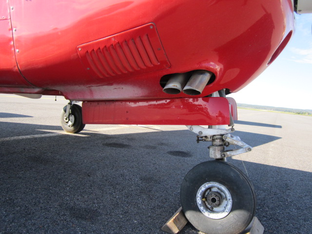

I always thought it was a pretty foolproof system. The gear is only held up by hydraulic pressure from the power pack. Pull the emergency extension and the pressure is removed. Gear falls into place. The nose gear is aided by the wind and the wing rocking is supposed to lock the mains but I don’t recall that procedure.
The Arrow is also supposed to have a fool-proof automatic gear extension. The pitot tube on the left side is connected to another pressure relief valve and if the power is chopped at a low speed, down the gear goes.
There’s an override for this so the gear doesn’t drop when doing stall practice etc. It’s spring loaded down by the flap lever. But most I’ve seen are locked into the override position. So much for fool-proof.

The Arrow's nose gear extends forward against the airflow. I'm not sure that the wind helps it. I think that big spring is what pulls it into the locked position.
- Posts: 8132
- Location: Winterfell...
Re: I Always Wondered About the Arrow Manual Gear Extension
Yes you are right. I was confusing it with the Seminole.

I think you mean the Seneca. It is the only Piper twin with a forward retracting nose gear. For what it is worth I had a battery master relay fail at night in a Seneca which killed the entire electrical system. To get the gear down I pulled the emergency gear knob which resulted in an almost immediate aerodynamic indication the gear was down. I did not a few good yaws to make sure it was locked and using my flash light I could see the nose wheel in the nacelle mirror, so I landed and taxied in.iflyforpie wrote: ↑Mon Dec 07, 2020 9:05 am

I suspect this Arrow had weak springs that could not overcome the air loads.
It appears from the original report that none of the gear came down, which makes me think that there is more to it.
For my experience with several Arrows, the gear free falls with ease. I can't imagine sticking up any one, much less all three. As for the nose gear, it would be wise to be flying more slowly when doing a free fall extension, the less air load the better.

The landing gear will freefall through a mechanically linked shuttle valve know as the "hoof valve". No electrics required for it to operate. The auto extend system was abolished by Piper after a dead stick landing when the gear kicked out and the airplane didn't make the airfield...they will not support it or sell you parts...or tell you anything about it. They force you into an SB to disable that feature. As the gear aren't mechanically linked, and the gear is held up by an electric driven hydraulic pump...something is odd here. The landing gear should have started to extend with the loss of electrics as there are no uplocks, and certainly should have freefallen if the emergency extension was selected
You are right. Very simple system so very odd that it ended upon its belly. Most likely unrelated but I have had issues with weak springs on the Piper single engine retractables.
