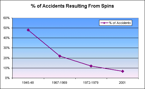

RedAndWhiteBaron wrote: Wed Jan 06, 2021 8:44 pm What I fail to understand is why comprehensive spin training should not be taught. I can understand that it may serve no useful purpose, but I cannot see the harm in it if you have the opportunity.
Statistically speaking, fewer pilots die this way.

RedAndWhiteBaron wrote: Wed Jan 06, 2021 9:35 pm Cite your sources, and I will believe you. I have only subjective experience and anecdotal evidence.
I actually don't mind if you believe me or not, but this is a graph produced by AOPA:
In this article:
https://www.aopa.org/asf/ntsb/stall_spin.html
Where the author points out that spins were removed from US PPL training in 1949:
Removal of a spin requirement for private pilots created much dissent on the part of instructors and other aviation professionals, who forecast an immediate and dramatic rise in the number of spin accidents. It didn't happen. In fact, since elimination of the spin requirement for private pilots, the incidence of stall/spin accidents has actually decreased substantially.

Re: Spin Recovery Altitude
I think spin training is very much about spins, or at least, avoiding them. I wouldn't confuse spin training from unusual attitude recovery training. Spins can occur from very "usual" attitudes, if you mishandle, for example, the rudder. But you have to work quite hard to end up, for example, accidentally upside down in a small airplane. Accident statistics suggest an unintentional spin is quite easy, hence the emphasis on recognition and avoidance.
Well, the rather quick drop after the war can likely be explained by the rather large influx of war trained pilots returning home. It would be interesting to compare those 1950 stats to stall/spin accidents in the war.
But - I acquiesce, at least until/unless I can provide a better counter argument.
If war-trained pilot expertise prevent spin accidents, then the lowest number of accidents would be 1945, when all those pilots were demobbed, followed by a gradual rise afterwards as the pilot population was augmented by new pilots with only civilian, post--war training.

photofly wrote: Wed Jan 06, 2021 9:57 pm If war-trained pilot expertise prevent spin accidents, then the lowest number of accidents would be 1945, when all those pilots were demobbed, followed by a gradual rise afterwards as the pilot population was augmented by new pilots with only civilian, post--war training.
That's what I'm arguing against. It would seem from your graph that the highest rate of stall/spin accidents was immediately post-war after they returned. Too many barn burners, and then, it seems to have become safer, very quickly.

RedAndWhiteBaron wrote: Wed Jan 06, 2021 10:33 pm That's what I'm arguing against. It would seem from your graph that the highest rate of stall/spin accidents was immediately post-war after they returned. Too many barn burners, and then, it seems to have become safer, very quickly.
Yes - the cadre of civilian pilots trained post war are the ones *not* trained in spins, and they are the safer ones. As they dominate the pilot population, the proportion of spin accidents declines. An obvious conclusion is that pilots not trained in spins are safer, statistically speaking.
