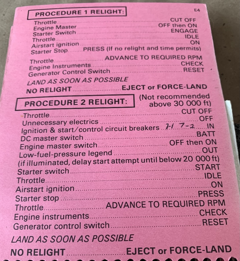

Really ? What have I no clue about ?
I am quoting the CT12-114 -000/MC-000 Normal Ops Procedures manual that I have access to.
Please show me the page in your manual where it suggests turning back to the runway , because it’s nowhere to be found .

I remind again, this is an Accidents and incidents forum were we discussed such events ...... get it Karen?
Further , still have not seen anyone come up with a copy of this “turn back to the field procedure”
Does it exist or is it just an unsaid rule as some here suggested ?
Respectfully I’m not saying it does or does not exist but for some reason nobody can produce it here

I have tried to post the manual page I am quoting
I’m told it’s from the latest version and like said , not turn back procedure but many here who say they are military state that
turning back is a procedure that they are taught in the RCAF
How many manual are there on how to fly the Tutor would there not only one ? The latest revised version ?
No I do not feel I’m an expert , you used that term not me .
Whether you are in a light aircraft or high performance aircraft , the principles of flight are relatively common
Trying to make it back to an airfield after engine failure has always been a no no . the SB’s have had other unsuccessful event like this so , jet a/c or not it’s obviously risky.
So why teach this method when landing as straight ahead as possible or ejecting is so much safer ?
I would assume ejection would be the safer route than riding a jet aircraft into a farm field somewhere
Keeping a relatively straight flight path while maintaining airspeed is surely safer than risking the loss of that airspeed by turning back to the airport even in a high performance aircraft , so why does the RCAF use it ?

Here is the page from the Tutor manual
Sorry for double picture , I had trouble posting it

fleet16b wrote: Thu Apr 01, 2021 8:06 pm Here is the page from the Tutor manual
As I said you have one manual. Does your manual describe the forced landing pattern. Where high key, low key, and final key are and crossing altitudes. How to deal with excess altitude. How to assess your profile? What speed you should glide at. Threshold crossing speed.
You have the AOI’s (it may be named something different 20 years later). It is says eject or forced land. The book you are looking for is the one that tells you how to forced land. Forced land does not mean don’t turn!
I have let you know this several times.... there is more than one book! And you have neither te information or the experience to be making your conclusions.
You also don’t have the wisdom to not say things in public forum that shouldn’t be.

I understand there are more than one manual
Many people of told me that the turnback procedure is part of one of the manuals but nobody seems to be able to produce that and that’s all I was asking for.
With regard to the conclusions of how the accident happened, was I or any other forum member here wrong when we concluded
that he attempted to return to the field and it resulted in a stall ?
The RCAF announced that publicly so why can’t it be discussed here? It’s may be sensitive to some but it is why this section was created

I pretty sure you know that force land means minimal turning as possible and definitely does not suggest turning 180 deg back to the airfield
Doing shallow turns 45deg to the left or right to make a field is one thing but I doubt a 180 deg turn is what the manual suggests
