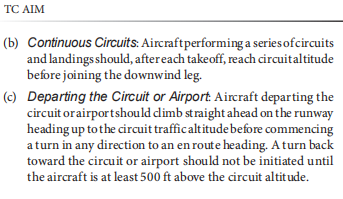

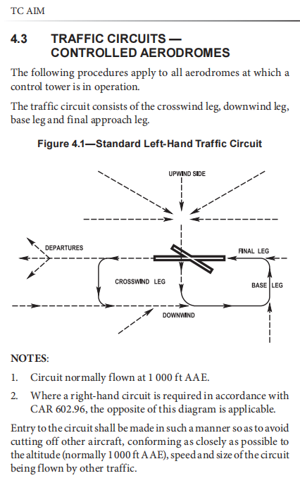

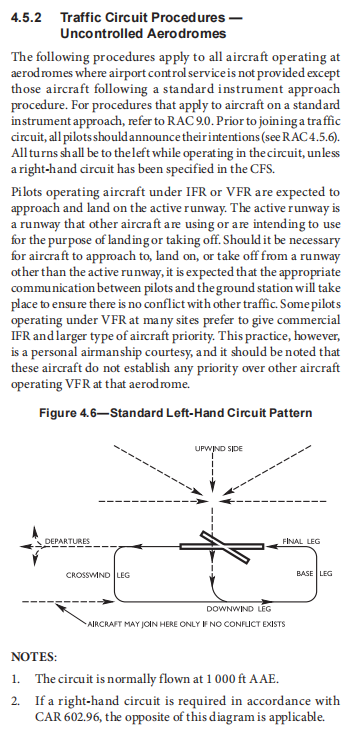

Here is the takeoff clearance for the occurrence flight (VFR):
Controller 2 (in training): “Bird Dog one six zero, tower, left or right
turn on departure your choice, winds one nine zero at 6 cleared
takeoff runway one two.”
Occurrence pilot: “Cleared takeoff twelve and I’ll do the left turn
out again, Bird Dog one six zero.”
Controller 2 (in training): “Roger.”
I could not find any reference for minimum altitude to start the turn for a clearance like this at a controlled airport, for a VFR flight. There is reference in the AIM about circuit altitude at a controlled airport:
and this is for an uncontrolled airport:
and this is departure procedures at an uncontrolled airport:
So they use the words "should" instead of "shall", which generally means recommended rather than required. Personally, I try to follow this regardless if it is a should or shall.
