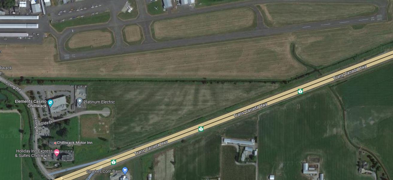

Seneca
Morris says she knew right away the plane was too low and began running as she watched it go through trees and crash beside the Chilliwack Motor Inn, just south of the Chilliwack Municipal Airport.
Morris says she and a co-worker called 911 and directed emergency vehicles through a field at the back of the inn to the crash site.
The registration number on the plane’s tail indicates the aircraft, which appeared badly damaged, is a Piper Seneca owned by SkyQuest Aviation, a flight school based in Langley. It was built in 1972.

From were it went down it certainly looks like one of 2 possibilities......
1) either they were doing engine out training on takeoff/landing and it went just horribly wrong or
2) they had an actual engine problem at takeoff/landing.
RIP to those on board.

I don't know what happened - I'm just theorizing....but look at the photo and see where the hotel is in relation to the airport. It didn't dive in from high altitude...they were way low skimming the ground before they hit.

Photo taken from unit 24 inside the motel adjacent to crash site. Blackberries 10-15 ft high. Many years since they have been cut back. The chief flight instructor had a pulse when first responders finally reached them, he died a little less than an hr later. At midnight they had just finished extracting all 3 bodies. Very sad. So very close to the airport, you can see part of the runway and some of the hangars from the same window, looking right (northeast). Picture was taken with cellphone out of bathroom window of Unit 24 in Chilliwack Motor Inn, the 25 unit motel adjacent crash site, immediately following crash, facing northwest. Witness who took photo recalls hearing the roaring engine get louder and louder, up until moment of impact, which they thought for sure was going to strike the building. 4 very old, tall cedar trees at the edge of blackberries had their tops clipped off by aircraft. Possibly adjusting its course (?)... Anyways... we live here at the motel....AMA.
