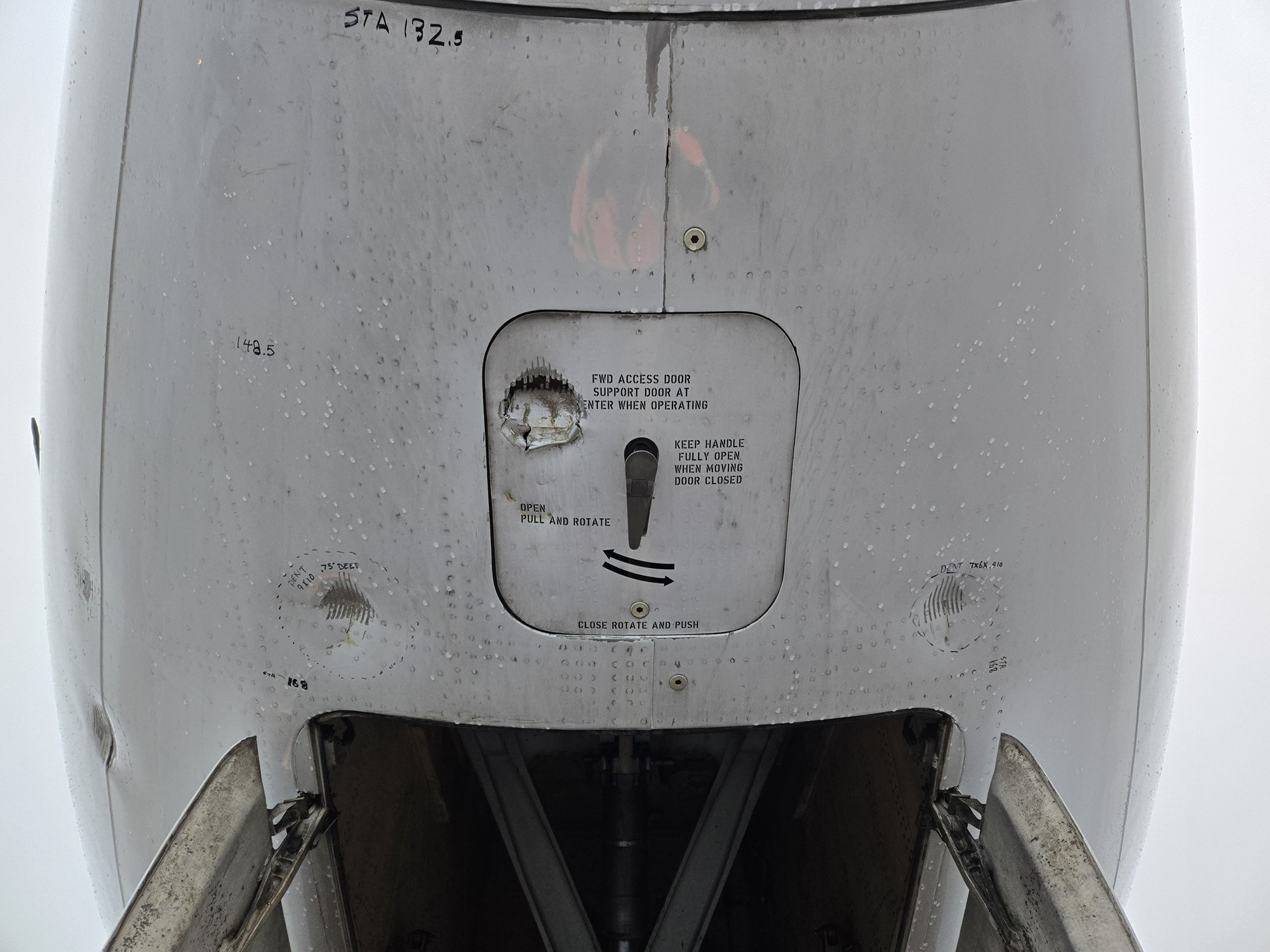

RH engine is FOD'ed out bad

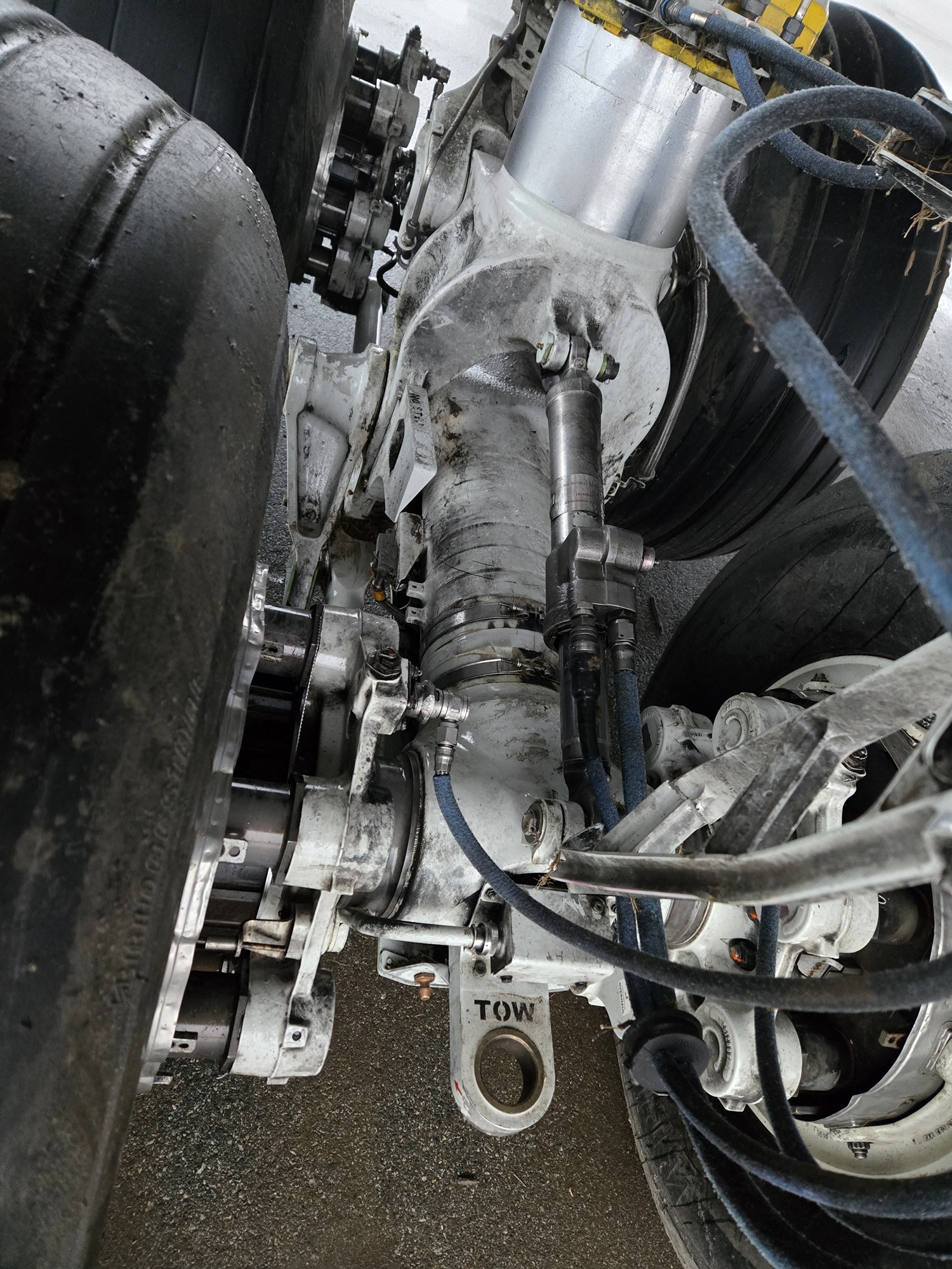

And finally the LH gear. For everyone wondering about air/ground switches. The switches in the 767 are internal to the tilt actuators. You can see the cannon plug here and both it and the wiring appear intact. If it was an air/ground issue....I don't think it's because of this (from the previous taxiway excursion.)
CJ18 LH main.jpg (1.09 MiB) Viewed 3441 times
