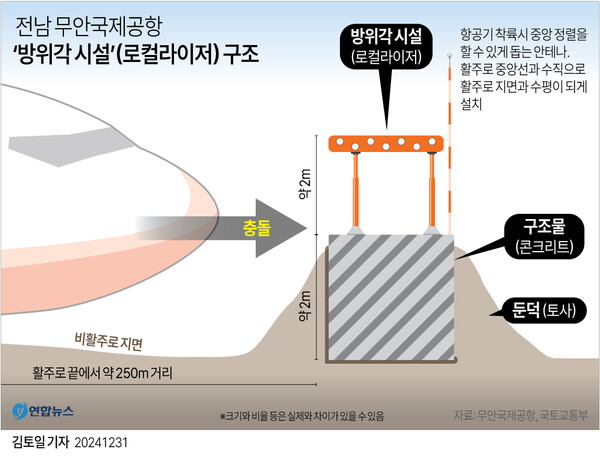

3) WHY is there a giant cement wall at the end of a runway?

Korea doesn’t even appear on this list.
