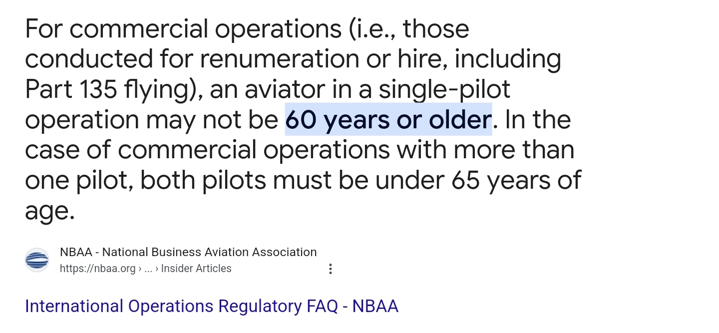

Let me restate my OP with less context so you guys can stay focused on what I really meant to discuss:
I recently learned that the FAA will not allow Canadian pilots aged 65 and over to fly under Part 703 and 704 to the USA. It was a surprise to me, I did not know this.
However, US pilots 65 and over who fly Commercially for Part 135 Operators in the US (the equivalent of Part 703 and 704 in Canada) are allowed to fly into Canada.
So US charter pilots over 64 are OK for transborder flying but Canadian charter pilots over 64 are not.
That is all I meant to state.

I'm pretty sure it's just Part 91 that you can fly beyond 64 (65+). Not 135, as 135 is similar to 121, limited to under 65 for both pilots, domestic or international. So, Gilles, to answer your question, no, charter operations cannot enter Canada with pilots (either) over 64 from US, due to US restrictions only, not Canadian.Gilles Hudicourt wrote: ↑Mon Nov 11, 2024 7:13 am Let me restate my OP with less context so you guys can stay focused on what I really meant to discuss:
Some years ago I learned that Transport Canada regularly issued FLVCs to US licensed pilots to fly for 700 operators in Canada although the US did not reciprocate. To fly for a US 135 or 121 carrier, one needs a real FAA licence.

The title of your original thread was "Corporate flying after 65". If the operation you are considering is corporate flight department they are most likely 604 on a PORD or 704. 604 or Part 91 has no age restrictions. So there would be no restrictions on you or the operation. If you are looking at an air taxi 703 or 704 charter that is a slightly different story.
Regardless of your opinion on the differences between FAA CFRs vs TC CARs, the majority of corporate flying for Canadian operators take place to, from and within the USA. Therefore, the FAA can afford to have "protectionist" regulations.
As for the FLVCs, Transport does not issue them without expressed and verified need from an operator. They are also issued with an expiry date. Therefore the need for the FLVC has to be re-evaluated and verified by TC. So there actually is indeed a small amount of oversight on the FLVC process.
