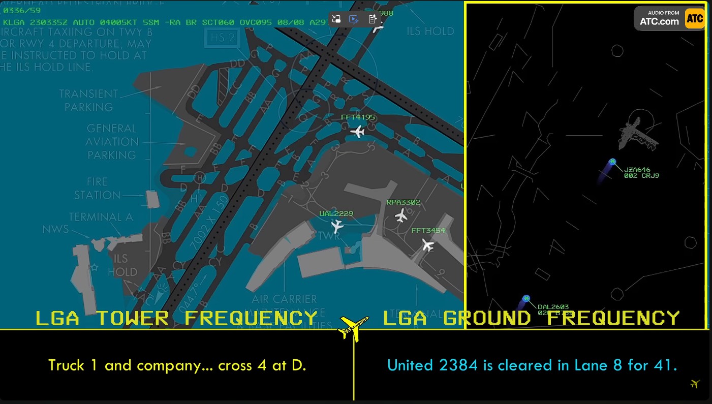

Truck 1 and Company (a line of several trucks behind Truck 1) requested and were cleared to cross RWY 04 on TWR frequency, not Ground. Truck 1 was probably on the Ground freq. initially, as they were on the taxiways and was probably told to contact tower holding short of RWY 04 and that's what they did.
Jazz was at about 150 ft AGL (according to VASAviation) when the trucks were cleared across. Very little time to make a decision to go around. They likely would have had to touch down anyway before reversing the decent and who knows if they could still clear the truck 1500 ft beyond the touchdown point.
Screenshot 2026-03-26 151453.jpg (191.7 KiB) Viewed 877 times
https://www.youtube.com/watch?v=XniNV73Gc2E&t=324s
