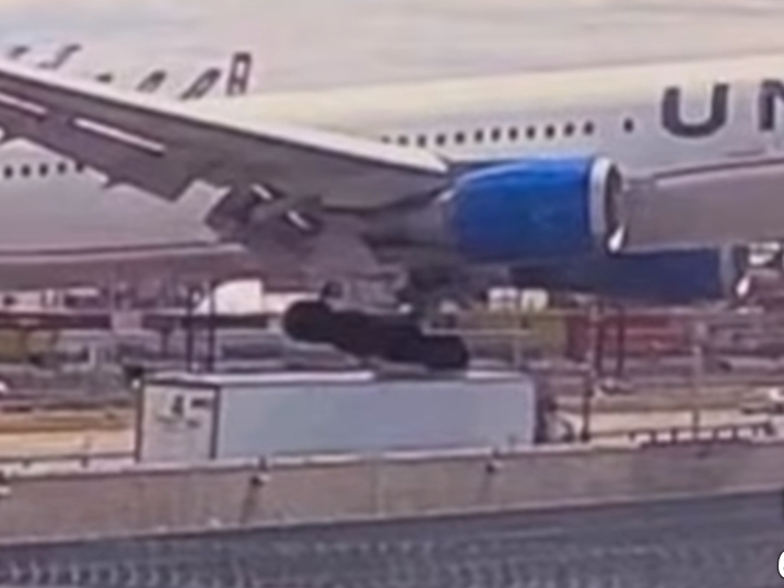

There's pictures of the 767 with a gash in the fuselage and damage to one of the tires.
It's also unclear if the photo in post #3 of the 767 and the truck is real or fake.

There is security camera footage - the still in post #3 is from that footage.
Shows just how close to disaster they came.

The part that has me wondering about that approach. Apparently it's a visual approach, with a relatively tight base turn, and no vertical guidance other than a papi. The road is 1600 feet from the touchdown point, 600 from the threshold. On a 3 degree descent to the touchdown point, that puts the altitude at 85 feet above the runway going over that part of the road. Now do some basic arithmetic. If on the lower bound of 2 red and 2 white for the papi, and in the pre flare configuration, how much below the pilot eyeballs are the trucks of the main landing gear with struts fully extended. Add to that the roadway elevation is above the runway, just how much clearance is there between main gear and the road at that point, keeping in mind that vehicles are up to 14 feet high, and the light posts significantly higher than that.
There is no doubt the aircraft was indeed lower than a normal approach, but my question is more about 'how much lower' ? It may not be that much, and a slight drop easily happens when in the bumpy conditions that winds of 19 gusting 30.
So yes, ended up to low, but, my question is, how much below that 3 degree slope were they, possibly not very much...
Posts: 5981
Re: United 767 strikes tractor trailer and light pole landing in Newark
767-400 is a long, large aircraft.
RW28 EWR isn't typically utilized by WB aircraft, what type of PAPI is it? Maybe a P2? ie <25' EWH?
Eye to wheel height may be a factor here if they were on the PAPI, maybe they came in with 3 red, thinking displaced threshold, sorry runway, we'll come in slightly low, but on a PAPI designed for EWH only up to 25' they were very low, wheel height would be around 25' 250' back.
Threshold is about 250' from an elevated road, displaced threshold is less than 500' from the road. How high is the expressway? How high was that truck? If it was a car they may have cleared it...
