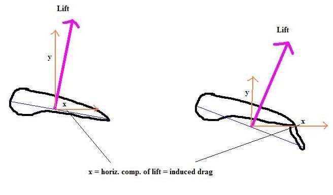

Because the induced drag you are thinking of is NOT the induced drag that's increasing. I remembering arguing this years back when I was a flight instructor with fellow colleagues as I discovered here in Canada vs the US, this type of induced drag doesn't get covered as thoroughly in training and texts.mcfly wrote:What i still dont get is..--> How can flaps increase Induced drag without Increasing Vortices? (in the context of safety when flying behind jets)
Is it because they split the induced drag into 2 weaker vortices per wing rather than 1 stong? 1 vortice @ flap tip and 1 vortice @ wingtip? ???
I'll put it as simply as possible.
The lift vector created by a wing is ALWAYS perpendicular to the wing chord line and since most wings out there are built with some degree of 'angle of incidence', the lift vector is always tilted slight rearward as opposed to being exactly straight up (or 90 degrees) in level flight. Therefore, this vector of lift has components both horizontally and vertically (X, Y). The horizontal component of the lift (X) is acting in the opposite direction of the flight path of the aircraft, therefore opposing it. This is the type of induced drag we are talking about here and what is altered with flaps.
When flaps are extended you are changing the effective 'camber' of the wing. Easiest way to view this is to draw two identical cross sections of wings on paper. On the second add a little hanging flap. Now draw a straight line between the leading edge and trailing edge of both cross sections. Notice the one with the flap has a steeper angle of 'chord' now. Now draw your lift vector exactly perpendicular to both of those lines. See how the one with flap is more rearward, therefore the horizontal component increases while the vertical component decreases hence more of that lift vector is now opposing the flight path of the aircraft, hence the increase in induced drag in this configuration!
I'm sure now I'll read this back to myself and it'll be clear as mud. I will try to resource some diagrams to supplement this explanation as it is MUCH simpler to understand with drawings.

mcfly wrote:uhh....well if flaps increase CL, then flaps do indeed increase Lift."Flaps don't increase Lift, they increase "coefficient of lift" (or CL). "
Only momentarily as they are moving from one deflection to another. That's why you get the 'bump' you feel as you hit the lever. After that, Lift is equal once again to weight- if Lift were 'greater' than weigth, you'd accelerate upwards indefinately... F= m*a, yo.
So, during the movement of the control surface, you get a momentary acceleration. After it stops moving, the lift the wing produces is equal to the weight of the aircraft is equal to the lift that the wing was producing before the flap was deployed.
Try always perpindicular to the relative wind. Average relative wind, that is. Think of flaps as creating the same amount of lift, only at a lower speed. So the CL does change, and for the same lift, you need a lower speed as is evidenced by:TFE731 wrote:Couldn't find any so I took the liberty of drawing it myself:
Lift = CL½ρV²S
