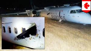

SAS Conducting Extra Checks of Q400 Gear
By Frank Jackman/AviationWeek.com
Scandinavian carrier SAS is conducting an extraordinary inspection of the landing gear on all of its Bombardier Dash 8-400 (Q400) in the wake of Sunday's accident in which the right landing gear of an SAS Q400 collapsed on landing at Aalborg, Denmark. There were no serious injuries among the more than 70 passengers and crew on board. According to Ascend's CASE database, SAS operates 23 Q400s with an average age of six years.
In a statement released Monday, SAS said that although it regards the Aalborg accident as isolated incident, it has decided to launch the extra inspections immediately and expected all aircraft to be inspected within four days. The aircraft are being checked in consultation with Bombardier, SAS said, adding that the inspections are not expected to affect scheduled traffic. SAS's decision to implement the special inspections came after discussions with Bombardier on Monday. SAS said Bombardier confirmed "that what happened in Aalborg has never occurred before with this aircraft type at any airline in the world."
According to SAS, flight SK1209 was enroute from Copenhagen to Aalborg with 69 passengers and a crew of four when a problem with the aircraft's main landing gear was identified. The pilots prepared for a controlled emergency landing and, after landing, the right main gear collapsed. Five passengers were "lightly injured" during evacuation, SAS said.
The Danish Accident Investigation Board will investigate the accident.
Posts: 7706
Re: SAS q400 gear collapse vid
Looks like the new procedure is to shut down the engine on the affected side as a precaution...
"C-GJZD, a Bombardier DHC-8-400 aircraft operated by Jazz Aviation LP, was conducting flight JZA8533 from Toronto/Lester B. Pearson Intl (CYYZ), ON to Thunder Bay (CYQT), ON. Upon extension of the landing gear during the approach at CYQT, the flight crew did not receive a down & locked indication for the left main landing gear, on both the advisory panel and the alternate indicator on the floor. A missed approach was conducted, and the flight crew performed an alternate landing gear extension; however, it was unsuccessful. In accordance with the QRH, the landing gear was pumped down 30 to 50 times with no effect.
The flight crew declared an emergency, shut the number 1 engine down as per the procedure, and requested ARFF in attendance. The cabin was prepared for an emergency landing, and passengers were briefed. The subsequent landing was conducted without further incident with the left engine inoperative.
The aircraft was towed to the gate. The operator's maintenance replaced the Proximity Sensor Electronic Unit (PSEU), and repaired wiring at the landing gear down-lock. Landing gear swings were performed with no further faults."

To create an emergency (as defined) and thus compounding an existing emergency makes sense to me - not-. Maybe the Danes made the right choice in getting rid of the aeroplane. Concerns of prop shredding passengers is likely the reason for the shut down. Is this really part of the QRH and if it is I'm thinking this is a major issue for the aircraft and needs to be addressed. How can an aircraft be certified if this is how they deal with a gear issue. Who can shed light on this?

Interesting viewpoint. The debate on whether or not to stow an engine for a gear problem is not new and it is not restricted to just this one aircraft.
Indeed it has been discussed and debated for years and we have all seen the guy landing gear up vids with engines caged but the issue is whether it's approved in the certification of the the aircraft. I ask again what is the QRH and emergency check list saying. Shutting an engine down in a "multi" is not considered and emergency but in a twin it is. You have now created a compound emergency. One would look pretty stupid to land without incident with the gear only to go off the runway (or anything else caused by having an engine shut down) because you out thought yourself.

valleyboy wrote: Mon Jan 14, 2019 9:36 am Shutting an engine down in a "multi" is not considered and emergency but in a twin it is. You have now created a compound emergency. One would look pretty stupid to land without incident with the gear only to go off the runway (or anything else caused by having an engine shut down) because you out thought yourself.
Stick to the simulators if you can't land a dash on one engine. Also, there are multiple reasons to use a turboprop over a turbofan, it's not just about comfort and noise.
The QRH in the Q400 does direct the flight crew that they may shut down the engine with due consideration for flight conditions etc. (at Jazz anyways)

cloudskimmer wrote: Tue Jan 15, 2019 7:40 am
And whomever is sitting in the row(s) next to the prop probably would appreciates that.

linecrew wrote: Tue Jan 15, 2019 11:23 am
Unless you’re going to cage an engine every time a tire blows and you still have safe gear indication, it wouldn’t have helped in that case.
Certainly but being paid the big bucks the decision has to be made to think about the majority's safety. If it's 200 and 1/2 would you cage a perfectly serviceable engine or would you attempt to move passengers and if seats are full would you move passengers and wedge them in some where to clear the prop strike area. We are getting into an area where SOP's don't necessarily make it entirely clear and there might be some creative thought required. In this day and age that can bite you even if you salvaged the problem and no one got a scratch --
Is this offered as a sim scenario in anyone's training syllabus or do they write it off as "multiple unrelated" - no matter what you do it will be on social media from cabin prep to the end result. :evil:

Given the direction of rotation of the prop, ingress of prop fragments in to the cabin, during a gear collapse is significantly greater on the starboard side.
I am not aware of any ingress on the #1 side.
