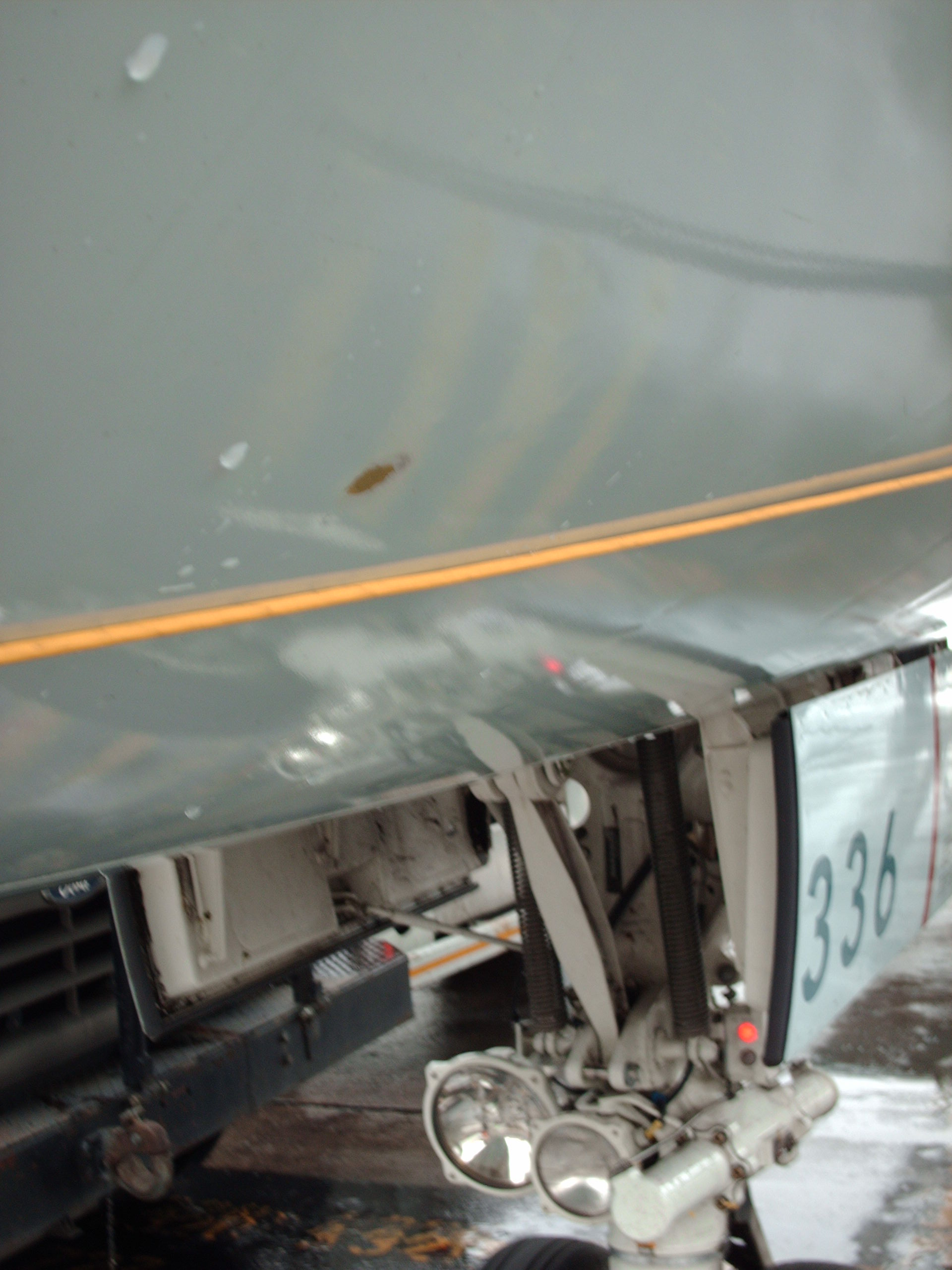

Check out the yellow spot...there was a pin-hole the size of a freshly sharpened pencil lead, left behind after a strike during our approach into Calgary. Nothing was affected onboard. It sounded like someone pounded their fist against the fuselage...and apparently the FA's saw a flash of light go along the outside of the fuselage.
(Sorry, I'm not much of an "internerd", so I don't know how to make the picture smaller.)
Lightning strike on an Embraer, during approach to YYC.
