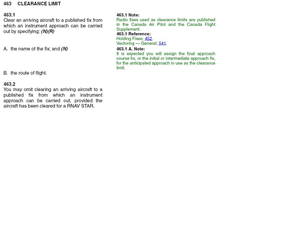

COM 3.16.5.2.2duplicate2 wrote:Do you have a reference section for this please?ahramin wrote:The AIM specifically states that when using RNAV you may be able to bypass the procedure turn and do a straight in.

Re: Straight-in Approaches
Thought I would get the definitive answer from the NavCanada Manops.
- manops.jpg (52.82 KiB) Viewed 2454 times
