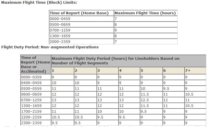

ivanhoe wrote:Does'nt sound like this guy is losing any sleep...
I've been on the A320 for the past 7 years. For the last couple of years, this is my typical pairing:
I do an early morning deadhead from Toronto to Varadero, Cuba. I then sit two days on the beach, followed by a 6+ hours flight to Calgary. Short layover in Calgary, and deadhead back to Toronto. Repeat again the following week, with the occassional Barbados layover thrown into the mix.
That lifestyle is only due to a negotiated agreement. The ACPA Collective Agreement limits one's duty period to 13 hours. As such, it is impossible fly Calgary to Varadero, and back to Calgary within one duty period.
As such, Air Canada has to position a crew in Varadero - so that they can have someone who can legally operate the Calgary - Varadero flights (under the terms of our Collective Agreement - not CARs). The crew that brings the flight into Varadero deadheads back, because they are illegal to operate, again under the terms of our Collective Agreement.
Nevertheless, under the CARs 14-hours duty period, a Calgary - Varadero turn is LEGAL.
Now imagine arriving in Calgary in a snowstorm after being on a 14-hours duty period. Nevertheless, the Westjet & Sunwing pilots do it because they follow CARs and not a more restrictive rule.
P.S. I personally avoid all duty periods over 12 hours, but I am only afforded that privilege due to my seniority.
P.P.S. Now that Westjet does Toronto - Barbados, are the pilots laying over there? Please don't tell me it's a turn.

ALPA to Pilots: Read Your Union’s Fatigue Recommendations to the FAA
September 24, 2009
ALPA has been trying to modernize the flight- and duty-time regulations for nearly 25 years, working with Congress, the Federal Aviation Administration, the International Federation of Air Line Pilots’ Associations, and the International Civil Aviation Organization to develop a model FTDT rule. These efforts culminated in June when FAA Administrator Randy Babbitt appointed members of labor, industry, and government to the FAA Aviation Rulemaking Committee. He charged the ARC with completing a comprehensive review of the current flight-time and duty-time regulations.
During the past two months, seven ALPA pilots from cargo, international, domestic, and regional airlines played a critical role in the ARC, which completed its work on September 1 with a group agreement to not release any information concerning recommendations to the FAA so that the agency could begin crafting a Notice for Proposed Rulemaking (NPRM). ALPA honored the information blackout, but other ARC participants chose to ignore it.
“While it remains our desire to not address any of the information that has been recently leaked in interviews to the press,” said Capt. Don Wykoff (Delta), who co-chaired the ARC, “we do feel that it is now appropriate for our members to review some of ALPA’s positions on these issues as well.”
ALPA’s 6-point recommendation plan focused on securing the following for our members: (1) one rule for all airline pilots, not “carving out” the cargo and supplemental operators; (2) a minimum 10-hour rest period; (3) a reserve rest rule for all pilots; (4) having multiple segments and circadian rhythm disruptions addressed; (5) establishing limitations on duty periods, flight duty time, and block time based on the fact that excessive working hours affect flight safety; and (6) requiring the operator to prepare and publish reliable schedules.
“We must have a single rule for all types of flying: domestic, international, and supplemental,” said Capt. John Prater, ALPA president. “There is no basis in science, nor is there a true operational need, to have separate rules.”
ALPA’s recommendations, based on operational experience and scientific study, incorporate ICAO and IFALPA guidelines and represent a comprehensive framework, in concept and in detail, of a flight- and duty-time and rest requirement rule. The concepts within your union’s recommendation demonstrate a scientific way of addressing both short-term and cumulative (long-term) fatigue safeguards for all operations.
Other concepts that ALPA addressed included a non-punitive provision for pilots to be removed from flight duties when they are fatigued, and a fatigue education program. ALPA is also proposing the following block and flight duty-time limits, as well as a 10-hour minimum rest.
While the ARC has submitted a report to the FAA administrator as the next step in the process toward issuing a Notice for Proposed Rule Making, several important steps remain in the process to create new flight-time and duty-time regulations, including putting the proposed rule out for public comment. The NPRM is expected to be published by the end of the year, according to statements made by Babbitt. ALPA will remain fully engaged in the process, and we will keep you updated on any further developments.
