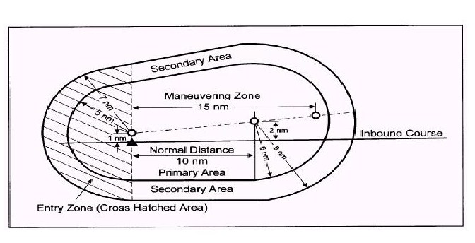

Re: Procedure Turn Question
Procedure turn design. Notice you are not safe within 10nm in all directions. The 10NM ring on the plate means nothing except to give you an idea of scale.
- P-5530086im.jpg (59 KiB) Viewed 1789 times
Of course, this is not a "10 NM safe altitude", that's why they specify the side of the PT.
