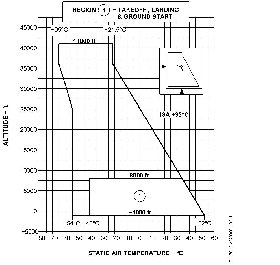

Is this what you're looking for on the Embraer? 52 degrees C for takeoff.
- Environmental Limitation.jpg (118.04 KiB) Viewed 634 times
Re: Question about Embraer E-Series and and Bombardier CRJ's
52 degrees C if you are operating 1000 feet below sea level! Like I said and the graph shows ISA +35 degrees C.
Well, he didn't say where he was operating. It could have been an airfield serving the dead sea for all I know. But...you win.
