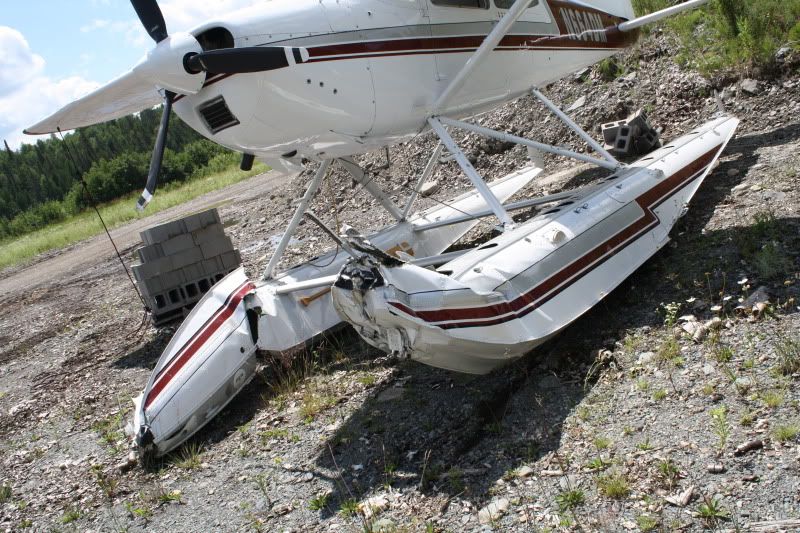

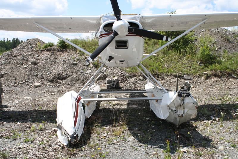

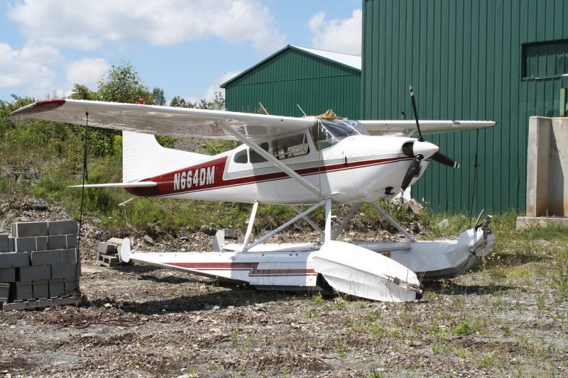

I watched it go down Monday morning. 11:30, nice and sunny, calm water, and about 20km's of wide open water behind where the plane landed. Not sure what he was thinking.
The aftermath:

Looks like I might get to sell my 2960s after all.

You also have a prop? He may need one afterall... :shock:

Looks like the water rudders are up. Any bearing on the accident?
Is an aircraft like that salvageable?

N number? They will fix it, and then sell it to canadians as a dry Arizona plane... :lol:

Nothing that a good sheet metal shop couldn't fix. :D

Water rudders are to be up on landing (gear was up too, this time) - that parts correct , he didn't have time to lower them for taxiing as there was no taxiing.

The prop is bent.

You need more than that. Sheet metal would be the least of my concerns because most of the metal damage (wing, floats) can be either easily fixed or repaired by replacement.
The immersion in water and the prop strike would be the kicker.
For immersion in water, all the interior has to be disassembled and dried or more likely replaced. All primary instruments need to be replaced or sent out for O/H. All circuit breakers and switches need to be replaced and all wire bundles loosened and dried. Avionics needs to be removed, dried, and function tested. The entire fuel system needs to be drained and flushed with solvent. The engine will need to be tore down and given a prop strike inspection (should cover the water immersion inspection as well) and the prop will need to be overhauled or replaced.
All in all, an expensive adventure...
