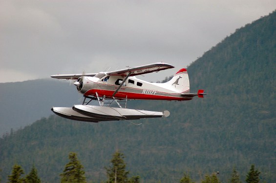

Here's a bit of an odd one.
Beaver & Rope.jpg (228.71 KiB) Viewed 3492 times

My first float job the boss hated the look of ropes on a/c so we always took them off and coiled them before we started up, docked then looped them back on. Good way to learn to splice a rope.
The rope on the tail of the Beav is so dock people don't have to grab the tail. I saw a guy grab somebody's fingers with the elevator and drag him off the dock - entertaining, for sure. Hell on fingers, though.

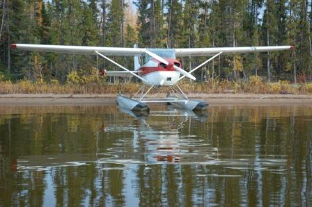

I use both wing and float ropes, leave them on, and have never had an issue. it's amazing when flying floats how many times you need a rope and cant grab one fast enough so i covered all bases, i wrap the rear float ropes once or twice around the strut of the float just to keep them away from the water rudder cables, but ive tried my hardest to get them caught up in them on the ground and have never been able to.
V
float rope.JPG (32.41 KiB) Viewed 2526 times
wing rope.JPG (50.75 KiB) Viewed 2526 times
