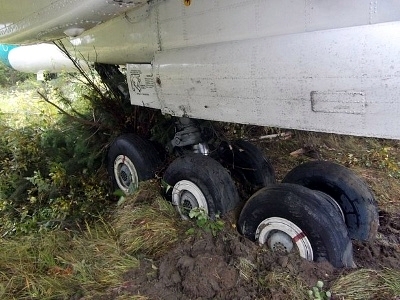

Here are some pics from the actual site. Web page is in russian,just click on the image to view the next one.
http://fotki.yandex.ru/users/selirom/vi ... 47/?page=0
Plans are to put it back into service, it has been pulled out of the "woods" and currently being examined and repaired for a ferry flight. It will be defueled and flown to a "ARZ" (avia remontnii zavod), stands for "aircraft repair factory". The biggest problem right now is the runway length...it's less than 3900 feet long.
Thats pretty deep
Thats pretty deep
Izhma TU-154M Main Landing Gear.jpg (101 KiB) Viewed 909 times

Actually, PS-90a, I enjoyed and appreciated the technical info you had on this aircraft type. Thanks!
It's wild to think they're going to put it back in service. I would be interested however, to see how they got it out of a 3900' strip, that's probably not able to handle the tire pressures.

That thing looks undamaged, russians can sure build tough planes
