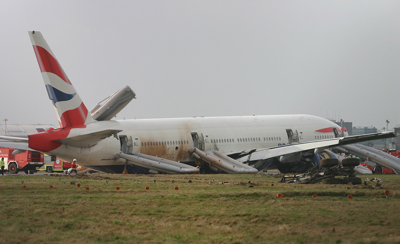

If your not on a DC-9-15 series, or an F-28/F-100 chances are you have zero to worry about.
Only two Boeing's have had problems regarding icing on takeoff - 6 weeks apart - a Sterling B727 in Gander (no one injured) but aircraft substantially damaged and the Air Florida in Washington - both had false air -speed indications and neither direct cause was the snow on the wings. Both incidents were 28 years ago!!!
The only mystery crash of a large commercial airliner due to wing contamination was the very controversial crash of the Arrow Air in Gander; Click Here. 25 years ago!!!!
Make that less than zero to worry about on the B777 - unless your
landing at Heathrow - but that's another story!!!! :) Click Here.
G-YMMM B777 British Airways LHR.jpg (131.96 KiB) Viewed 2230 times
