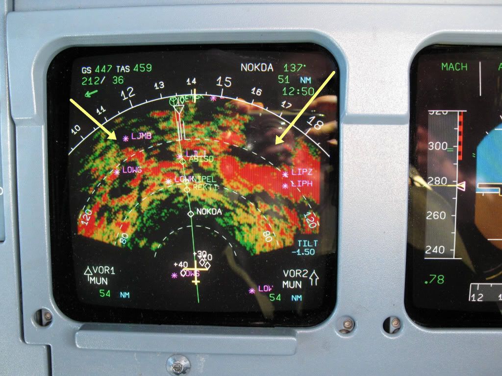

Re: Time of year for weather radar..
For those of us who do not have that much experience with WX radar.... please affirm ... the crew driving in the above picture is about to get f***** ?- or ... it was taken in the cockpit of AF 447 just before ......(history)

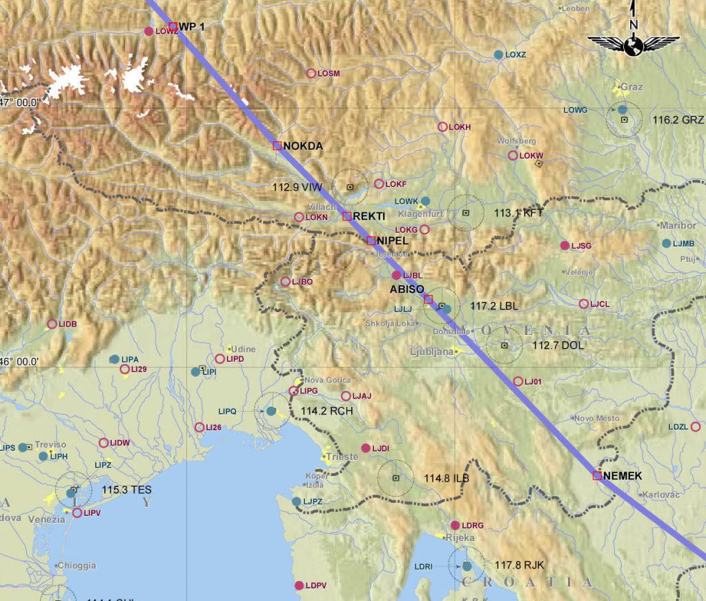

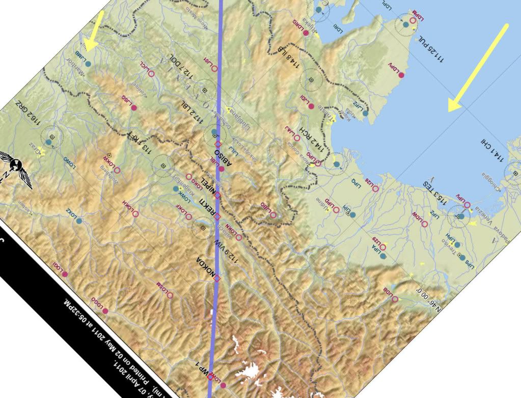

LJLJ is Ljubljana, Slovenia.
Situated next to a mountain range, of course.
I'd guess that at least some of those are ground returns from the rocks...no?
(the ground speed seems to suggest that he's at cruise though, and with only a -1.5 degree tilt down...that could very well be weather)
The picture above is showing almost all ground returns. This area is very mountainous.
The only possible weather I can see are a few returns on the left side at 40 and 60 nm.
My Airline operates in the Tropics and thunderstorms are a part of normal operations 12 months a year. The Monsoon is just starting at our home airport. Weather deviations of 60nm are not uncommon especially over India and the Bay of Bengal.
The biggest issue I have had using weather radar is getting any weather to display. Tops in the Tropics can easily reach 45000. There isn't much moisture in these tops and they do not show very well on the radar especially when the thunderstorm is dissipating.
At night or IMC I will set the gain to the MAX position. Tilt at -1 to -1.5 degrees depending on the altitude. Range scale is normally at 40 although I will go to the 80/160 scale periodically to see what is ahead. MAX gain gives a better picture of the edges of the weather as well as the location of the anvils.
It's quite common for nothing to show until 20nm from a top when we get a green return. This gives us just enough time to avoid the top.
On approach the biggest issue is visibility in heavy rain. I've had it happen twice that at 200 feet the rain was so heavy that we couldn't see the runway.
you guys are too smart.
From the middle to the right those are almost all ground returns of the Austrian alps. From the middle to the left actual thunderstorm cells.

Nice picture.
For the benefit the newbies or those who have never seen a weather radar display, I have included a map of the place this radar is showing. The aircraft is at WP1. (This radar display seems to be ground mapping.)
After the position ABISO, I just extended the line for the sake of argument. I also have tried my best to align the map to the route of flight so you can orientate yourselves better with the radar display, with rather horrendous results.
Reading a weather display involves quite a bit of practice to interpret it correctly. I am guilty of deviating around quite a few islands in the Caribbean at night thinking the return was showing a big CB when it was just showing the island. Likewise, I have crossed the Andes numerous times and thought the red display was just the mountains, until I saw the flashes of lightning.
It is sort of an art form mixed with a little bit of voodoo.
From its TAS and Mach number, this aircraft is at about 30,000 feet (FL300), direction of flight notwithstanding. Notice the range arcs on the display. Each arc is 40 miles. You can see a long way from up there.
On the right, LIPZ is Venice Italy. Just beyond it the display is black, meaning no returns on the radar. That is the Northern tip of the Adriatic Sea.
Over on the left LJMB is in a black area just behind an area of high ground. This would be a low flat area, but you have to be careful with these things because if the aircraft's FMS hadn't put an airport in there, you might assume it was just a low lying area when it could be a radar shadow from the high ground in front, hiding other large rock formations.
Come to think of it, I guess it is more Voodoo than art.
Enough ramblings for now. You get the idea.
