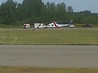

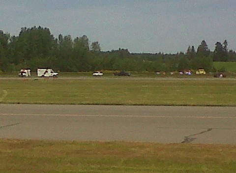

Yes the plane was manoeuvering to the east of the runway in a nose down attitude (approx 5-10 degrees) and had just completed an inverted manouever with a slight right wing down attitude when was unable to recover from rate of descent and crashed. No post impact fire, however it took first responders an agonizing amount of time to get to scene (3-4 minutes).
Needless to say YCD was closed to all traffic other than the medivac chopper....
BC Ambulance S76 arrives on scene to medivac pilot to Vancouver or Victoria....

Ambulances wait on runway while emergency crews tend to crash scene in background (looking east from flying club)
