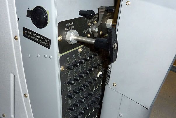

Re: Twin Otter question
I'm going to guess you are referring to the Cabin Air Control Valve, which regulates distribution of conditioned air between the flight compartment and the cabin.Apollo wrote:...Please tell me they moved the plunger from behind the F/O seat!
Yes, it has been moved to the center pedestal, directly above the avionics circuit breaker panel. The photo below shows the Ram Air control handle, which has also been relocated so that it is within reach when the pilot is seated and wearing the seat belt / shoulder harness. The Cabin Air Control Valve is symmetrically placed on the opposite side (you can see the attachment point of the Cabin Air Control Valve handle in the photo, the actual handle is obscured by the control column).
The function of the two controls has not changed in any way, only the placement of the control has changed. A Teleflex brand Bowden cable is now used for each of these two controls.
