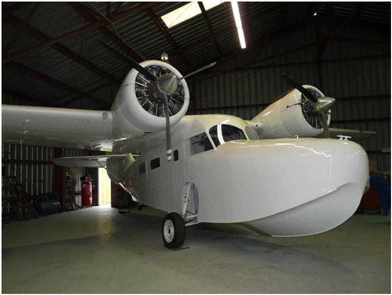

I understand I will not be flying any of those blue and white ones, its a new startup company. Here is a picture of one of the two birds, it has been painted since red, white and blue.

You'll have to excuse me... I assumed you were going to be working for Pasco. A new startup company with a couple of Goose's? Now I am intrigued... Look forward to hearing more! The one in your pic looks like it has the longer nose that the Turbo-Goose had...
