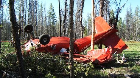

Fairly intense small plane crash from inside; everyone lives
http://youtu.be/yDu0jYiz-v8
2 cameras on board.
720p and fullscreen for maximum disturbingness. Crash at 2:44. There is a wee bit of blood after the crash, so don't watch this if that freaks you out. No screaming or anything tho', so at least there's that. Watch til the very end for the second camera view.
Original description: "This is unprecedented footage of a small airplane crash from inside the cockpit from two different views. Miraculously, everyone survived. The pilot will make a full recovery and the rest of us escaped with superficial injuries and feel very lucky to be alive . This trip was much anticipated and due to our excitement we had our Gopro cameras filming at various times. After flying up into the mountains for a hike in the Frank Church River of No Return Wilderness we were planning on flying to a small mountain town for dinner. Due to warming temperatures we had a hard time gaining altitude. After taking off we hit an air pocket that made us rapidly loose altitude, pushing us down into the trees."
Do you buy the 'air pocket made us crash' explanation?
2 cameras on board.

No, but I didn't hear a stall horn either. Halfway through that takeoff roll I was screaming ABORT, ABORT!!! inside my head.Sulako wrote: Do you buy the 'air pocket made us crash' explanation?

Sure looked like the plane really didn't like being out of ground effect, he would get it up there and she would just keep settling. The really disturbing part is just how long the PIC let this keep going on for, instead of just putting her down. I didn't time it but it looks like at least a minute of this before getting anywhere near those trees.
Re: Fairly intense small plane crash from inside; everyone l
FFS.  That is scary.  Had a nice long runway to abort.
Why wasn't anyone talking/screaming/yelling? Or is that just not picked up because of engine noise?

Nope, not a downdraft.  The air was too stable... hence the reason why they weren't able to pick up a thermal somewhere in that field.
It was at or above its absolute altitude for the weight and DA, flying along in ground effect or just slightly higher. Vy and Vx are the same at absolute altitude and the only speed you can remain airborne out of ground effect. Sees trees, pulls up, loses speed.... it becomes a mathematical certainty that you are going down.
There probably was no stall horn on this aircraft or the pilot was smart enough to realize that pulling further back wouldn't do anything... which is probably why they lived.

Once in the air, the crash was inevitable.  i don't understand why he flew it into trees after flying over open space for so long and having to know he wasn't going to clear the mountains... if he got that far.  Just incredible and isn't a "young" pilot.  Maybe just new to aviation.
I kind of doubt that they did their weight and balance for this flight with the given meteorological conditions... Seems like they hardly made it out of the ground effect.

Very happy and fortunate that everyone lived. Regardless of the technique and critique of the crash, it was fundamentally and logically correct, since they lived. Don't feel too bad armchair analyzing now.
But anyways, look at the AoA while over the trees, veiwed easily by the wing shot in the second camera. What ya all think? Futile attempt at reducing an absolutely unavoidable sink over the trees (cooler air/less thermal lift, or just climbing out of GE) or the actual cause of the crash itself? Tough to say since that seemed to be pretty much over its service ceiling of 100 ft/min anyways, like a razors edge at that point between climbing and sinking since it would probably sink at only a few kt either side of Vy... if it would have climbed at all.
But I digress.... Why didn't he just land anyways??! He had over a freaking minute of this staring him in the face?!!!

I thought I saw that, too ... not a good sign. I'mthe mixture is full rich for taxi
amazed the plugs didn't foul, and that the engine
kept running. I wonder if he leaned for takeoff?
Regardless, the aircraft was talking to him during
that bizarre takeoff, and he chose not to listen.

This video has been on the US news (CBS) today. It happened in Boisie Idaho area. PIC, two passangers and one of the rescue guys were guests.
PIC was lucky that before SAR helicopter has reached them, the people that came first to help were campers that are firefighters and EMS by profession. PIC sounded "dense" in the interview and I am not sure because he did not heal yet or is just like that naturally.

Flaps increase lift at the cost of drag.  This guy already
didn't have enough thrust to overcome what drag he
had, so adding more drag probably wouldn't have helped.
He should have rejected the takeoff. He had plenty of
opportunities to do so.
