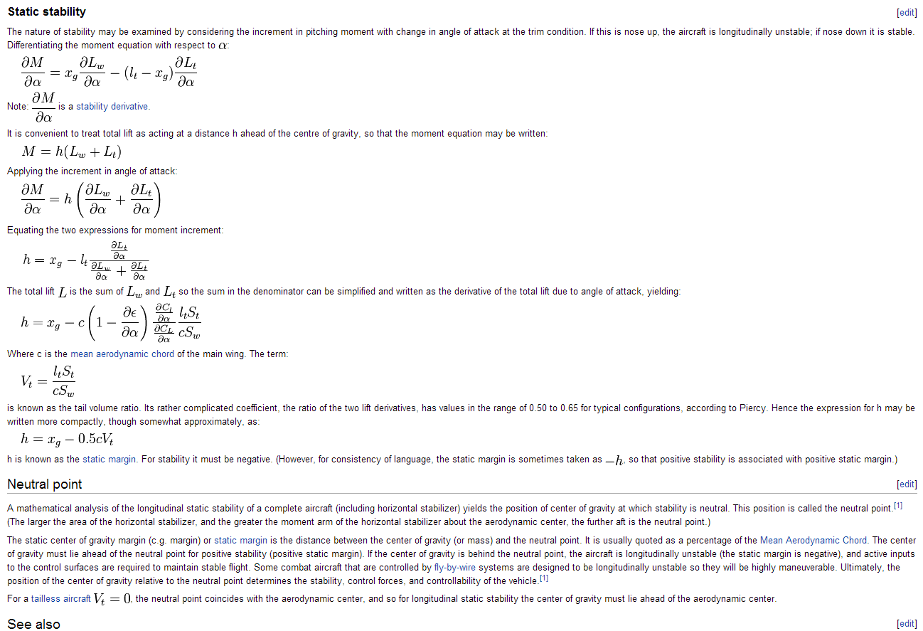

Re: Single engine Cessna tailplane lift
If you loaded a 172, in such a manner the tail had to create "positive lift" ... you would have to be a much better pilot than most as it would be unstable to the point it would be uncontrollable.
You cannot just simply look at the geometry of a static aircraft, and ascertain as to what the loads are in the tail (making assumptions as to where the aerodynamic center of the wing is in relation to c of g ect) It just doesnt work. Stability has to include all of the pitching moments about the the c of g ,including the pitching moment of the tail, wing, fuse, ect) If the tail were to ever become a "lifting surface" the aircraft would be very unstable. Something else thats also very important is a term reffered to as the tail volume ratio, but again, understanding of partial derivatives is required to grasp.
Wiki has some more good stuff...
- stability.PNG (90.79 KiB) Viewed 3126 times
I showed it for the 182; you want me to repeat it and see if it's true for the 172 also?
