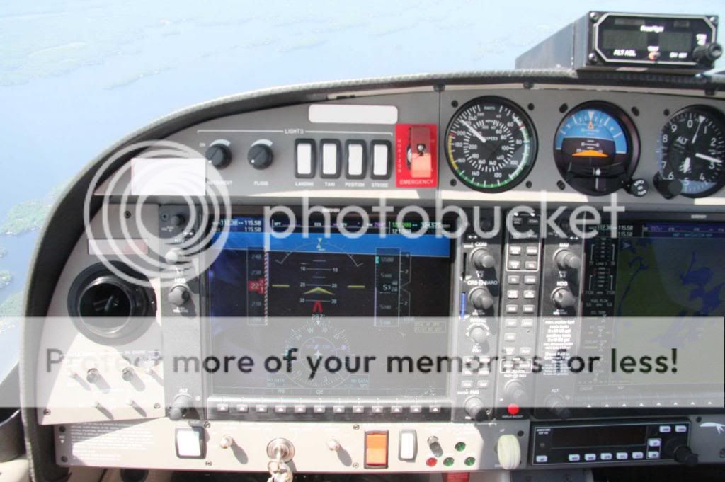

Here is an example of a spin (with inverted), which I flew as a part of certification testing. I practiced, and I had a plan. After 14 spins that day, I can attest that a Grand Caravan spins beautifully, but gives you NO room for error recovering. I never exceeded a limitation in the aircraft during the spins (other than simply spinning it to begin with - flight permit for that), but I did recover the resulting dive AT Vne, AND 2.8 G ('cause I took a G meter) and the peak rate of descent was 9200 FPM.
The limitations are specified for the aircraft to assure that it will not only be safe, but will always be pointed somewhere safe too!
