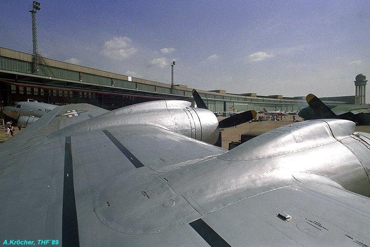

Re: Identify This Mystery Aircraft Piece:
Still not quite lining up...
Though it could be the outboard. The second P/N, ending in "-2 RH", suggests #4 engine?
- 973094962_Douglas-DC-4-C-54-Skymaster_MATS.jpg (76.63 KiB) Viewed 1558 times

My take on the two numbers is the 5169508-403 is the part number and the 523-2RH is the serial number and position for the airframe it was originally built for.
The numbers in the chart from aviationarchaeology.com are referring to the root of the part number i.e. 516####-###.
Reading the chart, that would imply the part is from a Northrop Grumman P-61, which doesn't check out. (there is a very similar shape on the bottom of each tail boom.. to make space for the wheels though)
My guess is that it is a Douglas part and that the aviation archaeology chart just isn't comprehensive.
There are a number of different intake scoop shapes for the C-47/DC-3s, but I didn't spot an exact match.
GyvAir, got to hand it to you Bud;
I wrote Craig Fuller at aviationarchaeology.com
He sent me the IPC pages for the A-20 and I'd say it's a dead ringer.
What has been bugging me all along with the DC-4 / C-54 suggestion is that 'joggle' on each edge, both sides. I had never been able to get close to one though to confirm either way and attributed it potentially to ambiguities of the IPC.
The A-20's fairing pictured, covers that and also, the prefix in the first P/N, (516), jives out. The last of the P/N is not an exact match but as Craig points out, there were many variations within production runs.
The "523" in the second number second number also pointed me to the C-54. I suffered target-fixation for a while there.
The A-20 is a logical conclusion for where the piece was discovered, as there were many of them ferried through YT en route to Russia by the 7th Ferry Group during WWII. Many also saw service in Alaska, during "The Forgotten War"..
