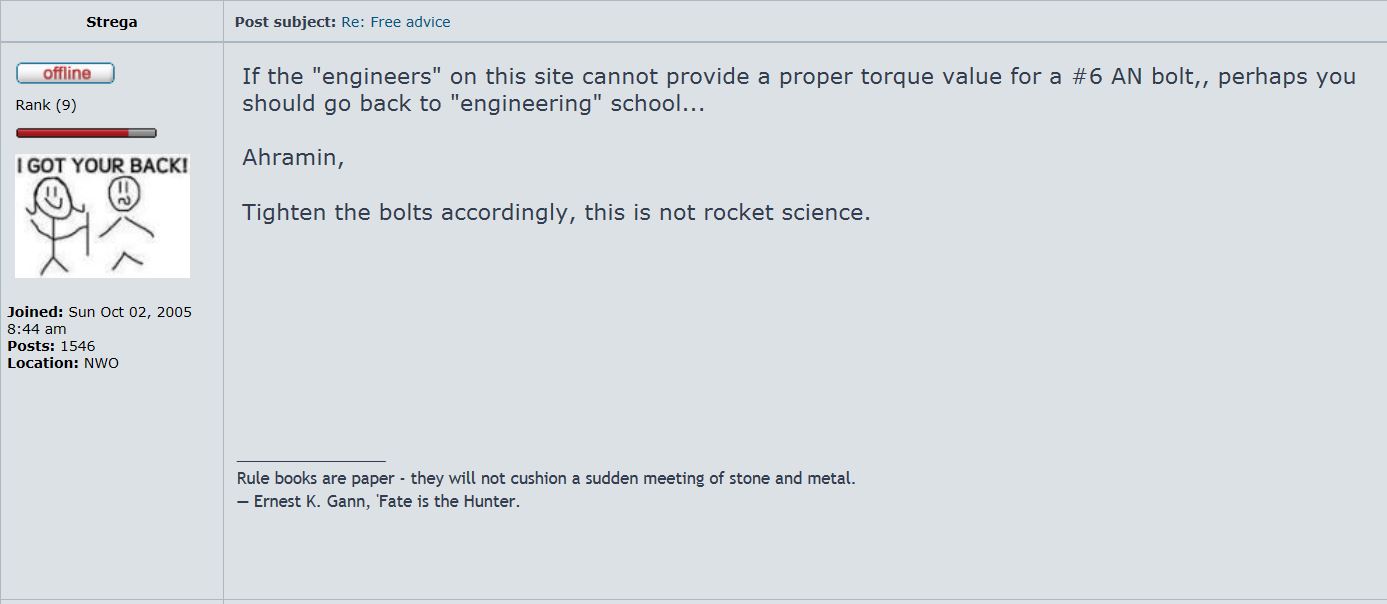

Read up on what Strega thinks of our job title....I'm sure he can write a mathematic equation on how to remove seized screws.
http://www.avcanada.ca/forums2/viewtopi ... 27&t=45345
http://www.avcanada.ca/forums2/viewtopi ... 27&t=47157
Re: Impact drivers (dewalt and the likes)
#6 AN bolt? That's new... :?

sorry mr pie "AN6".... Im sure you didnt know what I was speaking about..
Tcas.... keep calling your self an "engineer" while changing oil, and filing props...
Ok... I thought that maybe it was another one of your 'dividing by zero' things that only "engineers" seem to comprehend...
