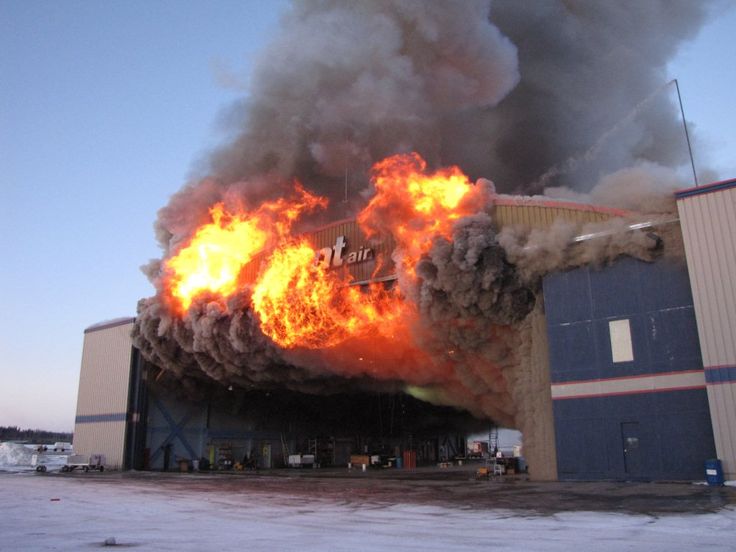

One of my operations had a hangar fire, and I'll never forget that vision of black smoke a thousand feet high billowing out the main doors as I drove around the curve leading to the airport. Have that experience, and you err on the side of caution from that point forward.
After all, is it really such a huge handicap to pull the machine outside for that sort of operation considering what the potential ramifications are?

dont do what airspray did in 1999 it was a very ugly situation

Ok...did insurance cover AirSpray? :|

Did insurance cover AirSpray's losses?
