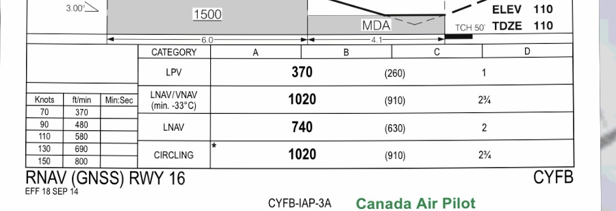

Why does this approach have higher LNAV/VNAV minimums than just LNAV?
Does anyone know why the LNAV/VNAV minimums are the same as the circling minimums and a lot higher than the LNAV ones? There's no NOTAM for an error.
Rockie
Posts: 8433
Re: Why does this approach have higher LNAV/VNAV minimums than just LNAV?
Post by Rockie »
Probably because at the lowest temperature the approach can be flown (-33) there is an obstacle that penetrates the depressed obstacle clearance plane necessitating the higher minimums. At that temperature the LNAV approach would have a corrected FAF crossing altitude whereas the LNAV/VNAV does not. Without seeing the actual data it's impossible to say for sure though.
Rockie wrote:Probably because at the lowest temperature the approach can be flown (-33) there is an obstacle that penetrates the depressed obstacle clearance plane necessitating the higher minimums. At that temperature the LNAV approach would have a corrected FAF crossing altitude whereas the LNAV/VNAV does not. Without seeing the actual data it's impossible to say for sure though.
I can follow the technical "we crank the handle on the TERPS machine and this is the sausage that drops out at the end" explanation.
Am I right in thinking that this means a pilot who has the choice of either can pick:
A)LNAV/VNAV - with vertical guidance presentation and a DA, but higher minimums - OR
B)LNAV - roll your own vertical guidance from the stabilized descent table, or chop and drop, and an MDA in return for lower minimums
Are there operations which approve *only* LNAV/VNAV? Why would a pilot choose A over B? And why would he or she not choose A initially, following the vertical guidance until the higher minima and then continue descent to LNAV minima anyway?
Post by ahramin »
photofly wrote:Are there operations which approve *only* LNAV/VNAV?
I don't know of anyone who uses LNAV/VNAV only.
On the heavies we add 50' to the LNAV MDA and use the FMSs VNAV down to that MDA.
I find these silly LNAV/VNAV minimums all the time on NavCanada created GNSS approaches. I'm guessing that in a misguided effort to make the procedure useful in as wide a range of temperatures as possible for non temperature correcting FMSs, they make the procedure completely useless for anyone at any temperature.
Post by Rockie »
photofly wrote:Am I right in thinking that this means a pilot who has the choice of either can pick:
You're correct, an operator can choose either of the minimums to use. However with a non-temperature compensated system the LNAV/VNAV cannot be used below the TLIM (-33 degrees in this case), and below 0 degrees the operator must correct the FAF crossing altitude and probably the selected flight path angle for the LNAV. Airlines do not use the "chop and drop" method anymore and must use constant descent angle procedures without leveling out at MDA.
Post by Rockie »
ahramin wrote:I don't know of anyone who uses LNAV/VNAV only. On the heavies we add 50' to the LNAV MDA and use the FMSs VNAV down to that MDA.
LNAV/VNAV is not just different limits than LNAV on the same GNSS approach, they are in fact two entirely different approaches with completely different obstacle clearance criteria. As was mentioned they are usually lower than LNAV minima, and as it has a DA rather than an MDA there is no requirement to add 50 feet to comply with CAR 602.128 (2)(b). LNAV/VNAV approaches aren't limited to NavCanada either, they are worldwide.

Post by Rockie »
photofly wrote:Are there operations which approve *only* LNAV/VNAV? Why would a pilot choose A over B? And why would he or she not choose A initially, following the vertical guidance until the higher minima and then continue descent to LNAV minima anyway?
Missed this part. There might be operators who only approve LNAV/VNAV but I don't know why they would give up the capability to do LNAV if the LNAV/VNAV was unavailable due to temperature. The LNAV can be flown at any temperature.
Given a choice though we would always choose the LNAV/VNAV because it's easier, and it provides vertical guidance rather than just selecting a flight path angle that may or may not be in the right place.
You would NEVER fly the LNAV/VNAV to minimums and then continue down to LVAV minimums in this case. As I said they are two separate approaches with separate obstacle clearance criteria and you run the risk of hitting something. The minimums are what they are because of an obstacle. It would be like flying a VOR approach then continuing down to ILS minimums.

I always thought that it was simply due to the fact that a DA makes allowance for a slight dip below that altitude when commencing a missed approach whereas an MDA does not need to make any such allowance. But then I have never encountered an approach with a difference as large as the OP's example.
Rockie wrote: You would NEVER fly the LNAV/VNAV to minimums and then continue down to LVAV minimums in this case. As I said they are two separate approaches with separate obstacle clearance criteria and you run the risk of hitting something.
If you (try to) fly a 3 degree approach path using the LNAV/VNAV presentation or using the CDA data on the plate, what's the actual difference?
Post by ahramin »
The LNAV/VNAV may not be 3°. Plus the LNAV/VNAV gives you vertical guidance that your FD/AP can follow.

Post by Rockie »
If you're on a true 3 degree flight path in both cases there is no difference, but the LNAV/VNAV in this case can be flown down to -33C and as the temperature decreases the flight path angle also decreases. The published minima is there for a reason and is not just some number plucked out of thin air, don't start making up your own procedures.

rxl wrote:I always thought that it was simply due to the fact that a DA makes allowance for a slight dip below that altitude when commencing a missed approach whereas an MDA does not need to make any such allowance. But then I have never encountered an approach with a difference as large as the OP's example.
Bingo... it's based on the missed approach and the fact the LNAV/VNAV is designed having a missed initiated from a constant descent.
