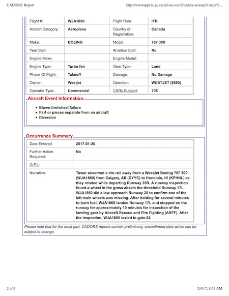

Before the thread drifts off onto an entirely unrelated incident, just curious where I can read about exactly at what point a geriatric 767 lost a wheel? Takeoff in YYC? Takeoff in HNL? Landing attempt in YYC?
kevenv
Posts: 695
Joined: Thu Apr 12, 2007 6:19 am
Re: Fire trucks following West Jet 767 in YYC
Post by kevenv »
complexintentions wrote:Before the thread drifts off onto an entirely unrelated incident, just curious where I can read about exactly at what point a geriatric 767 lost a wheel? Takeoff in YYC? Takeoff in HNL? Landing attempt in YYC?
complexintentions
Posts: 2186
Post by complexintentions »
Thank you.
