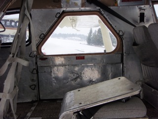

Not sure if I can get this picture thingy to work, but here goes a picture of our Beaver with the modified door handles. Pretty easy mod and it enables the pilot to open both rear doors without leaving his seat.
- PC050228.jpg (29.15 KiB) Viewed 2479 times

upside down, in cold, dark water and 3 fat turkeys in the way, a guy is going to be able to reach back from his seat, and open those doors? I dunno about that...
How about putting the handles at the leading edge of the door, right about where the pax knees are. That, IMveryHO, would be the best location..
