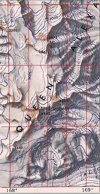

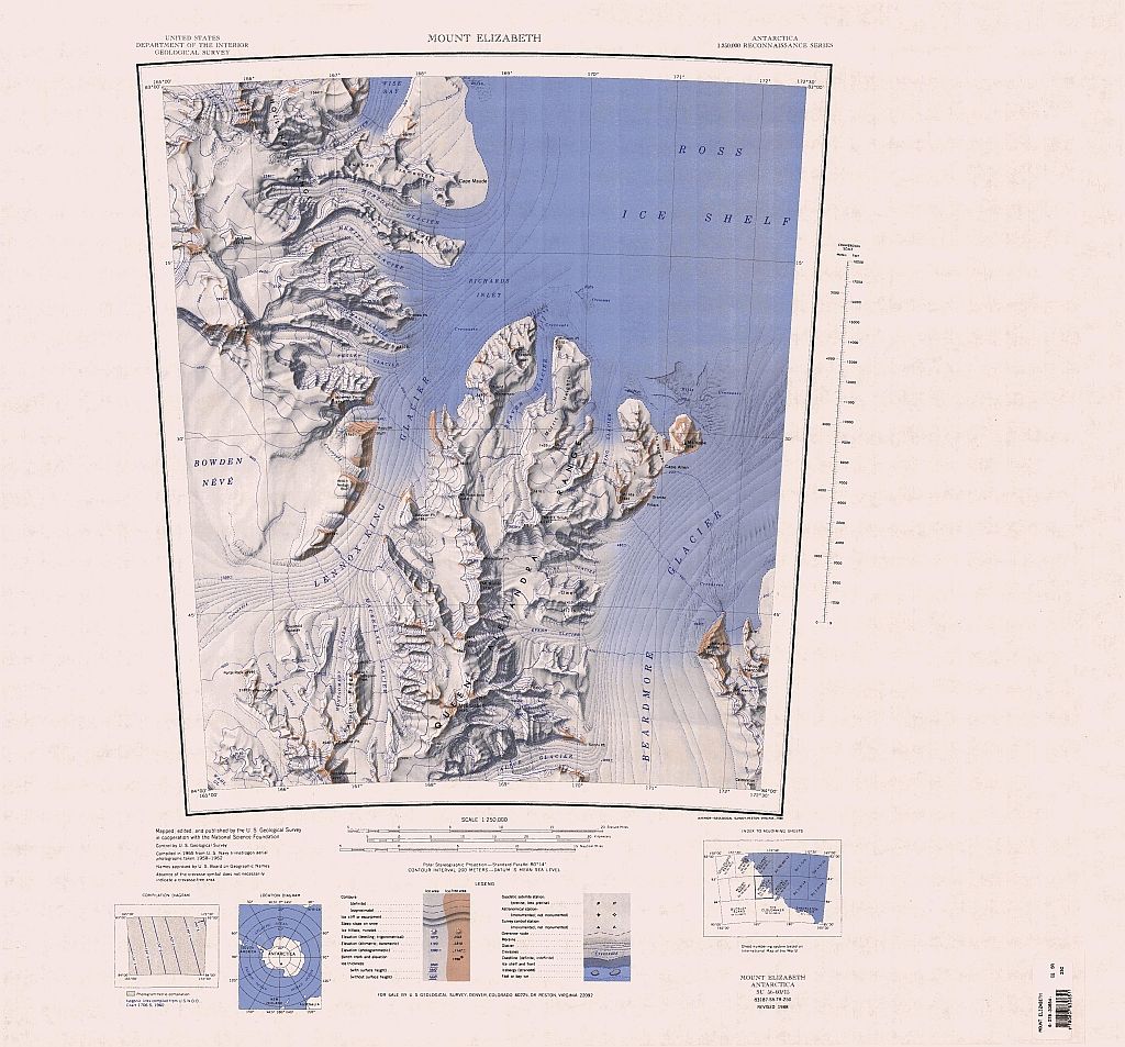

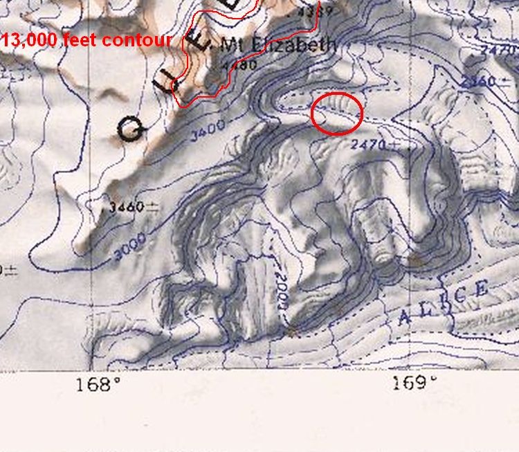

The accident site was reported as S83.9187 E168.7640 (S83 55.12 E 168 45.54)
The elevation at that point looks to be less than 13,000 feet (3960 meters)
Is there a more accurate location available? Or is the reported elevation wrong?
http://usarc.usgs.gov/drgs/dir2/c83172s5.jpg
Last edited by Lost in Saigon on Fri Feb 01, 2013 7:30 pm, edited 3 times in total.

I think that is the location of the 406 ELT signal, which is only accurate to a few miles if there is no GPS.Lost in Saigon wrote:The accident site was reported as S83.9187 E168.7640 (S83 55.12 E 168 45.54)
