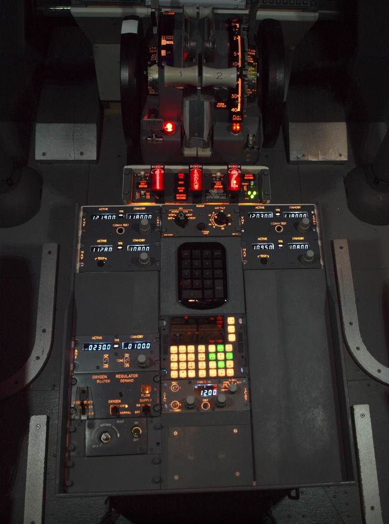

Now here is a photo of the actual pedestal...
Notice that the keyboard will desappear as soon I will have programmed the CDU keyboard, or what I think is a old 737-200 CDU. Am I right???
Alain

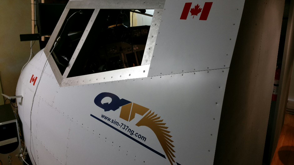

Thank you captain haddock !
I tried to make it as close as the real one! 😁
Not that bad i hope...
2018-04-11 16.42.33.jpg (82.22 KiB) Viewed 2689 times
