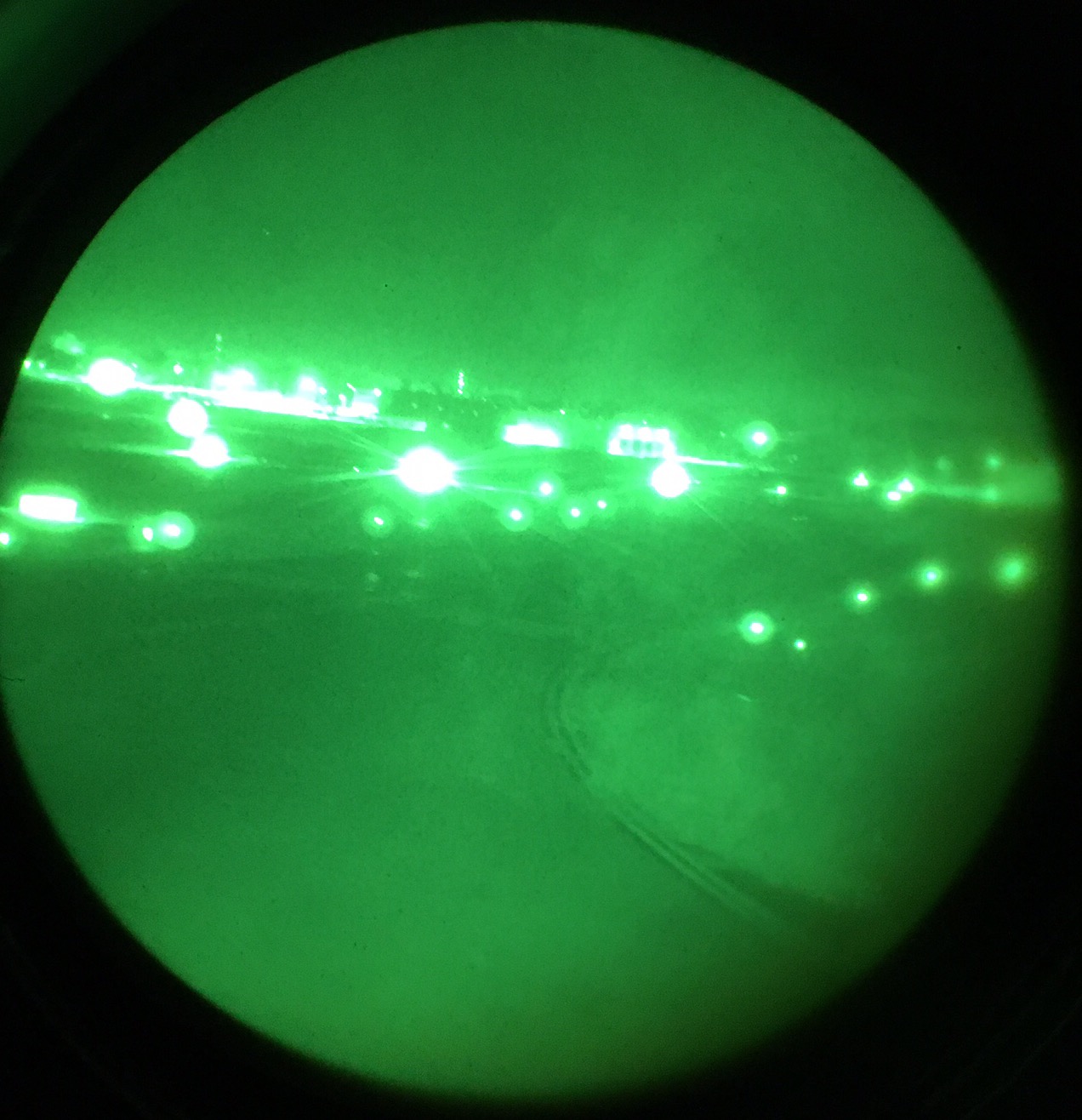

I know a guy who was able to capture LED lights under NVG.
You can see that part of the taxiway is lit. What you don't see is the LED's that are visible to the naked eye.
Another photo you can barely make out the light.
- image.jpeg (212.67 KiB) Viewed 1094 times
- image.jpeg (279.86 KiB) Viewed 1094 times
